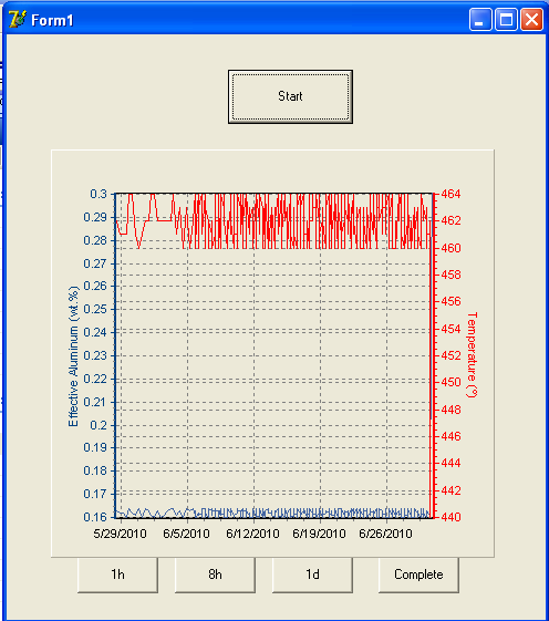

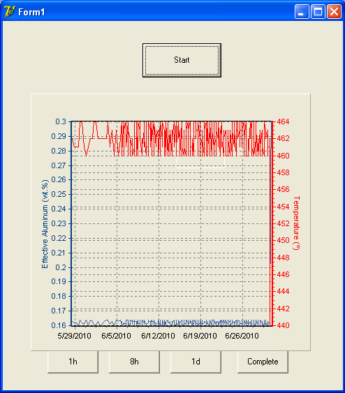

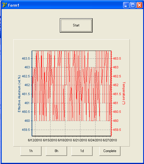

I am running Delphi 7 Professional on Windows XP using TeeChart2010 Standard. I have set up a simple chart with two series. One on the left axis and one on the right axis. The scales of the axes are very different. When try to zoom using a rectangle from top left to bottom right, the left and right axes now both the same scale (actually the scale of the right axis). The series associated with the left axis does not show anymore as the values are much smaller than the right axis. See attached pictures for better explanation.

I wanted the zoom to make the left axis go from 0.268 - 0.292 and the right axis to go from to zoom in 458.5 - 462.5. From what you are saying, using the rectangle will only change the right axis correctly. Is this behaviour repeatable? Will it always put things to the scale of the right axis or will it sometimes put it to the scale of the left axis?

I created a new project and inserted the computer code that you posted and I get the exact same result as previous. The scale of the left axis becomes the same as the scale of the right axis. That is not what I want...
