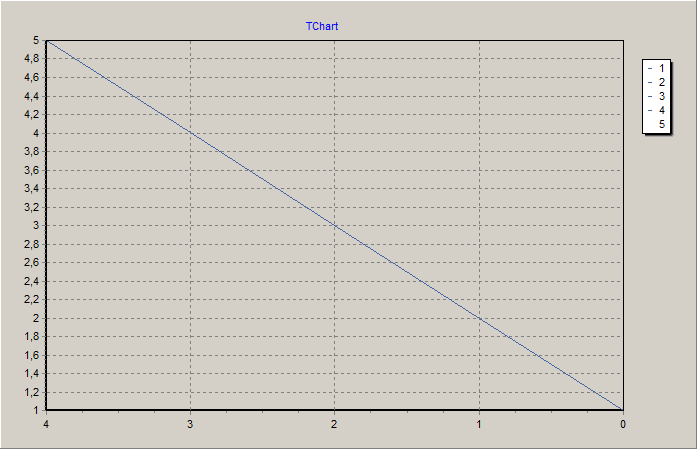

Post by Yeray » Tue May 11, 2010 1:06 pm
Hi johnnix,
Using even more simple code:
uses series;
  Chart1.View3D:=false;
  Chart1.AddSeries(TLineSeries.Create(self));
  Chart1[0].Add(1);
  Chart1[0].Add(2);
  Chart1[0].Add(3);
  Chart1[0].Add(4);
  Chart1[0].AddNull(5);
  Chart1.Axes.Bottom.Inverted:=true;
  Chart1.Axes.Left.SetMinMax(1,5);
I can see the following result in v8.06 and 8.07:

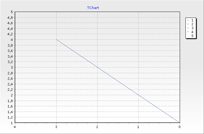

But also note that in v2010 it seems to work fine:
Anyway, I've added it to the defect list to be revised for future v8 maintenance releases (TV52014875).
