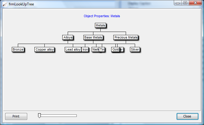

Post by TCardinal » Fri May 07, 2010 11:14 am
here you go
orgseries overlap
Posts: 9721
Re: Org Chart
Post by Yeray » Fri May 07, 2010 11:36 am
Hi TCardinal,
Yes, I see it is reproducible with the following code:
uses TeeOrgSeries;
var Org1: TOrgSeries;
  Org1:=TOrgSeries(Chart1.AddSeries(TOrgSeries.Create(self)));
  Org1.Add('Metals');
  Org1.Add('Alloys', 0);
  Org1.Add('Base Metals', 0);
  Org1.Add('Bronze',1);
  Org1.Add('Cooper alloy',1);
  Org1.Add('Iron',2);
  Org1.Add('Tin',2);
This series is quite simple right now. I've added it to the wish list to be improved in future releases (TV52014866).
Note that for more complex diagrams like this, there is also the TeeTree component given with TeeChart. You should have a demo of the TeeTree component features in your TeeChart installation path, into the Examples folder.
