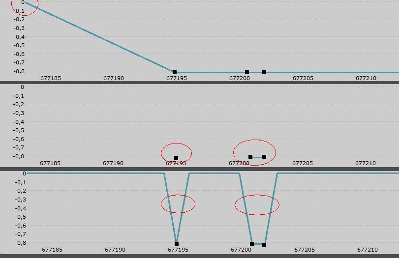

Hi Narcis. First, thanks for the reply. I had already thought of that solution. I eliminated it, because this produces effects graphics to represent the series:
Skip Nulls: when I scroll chart, the first value always start drawing at 0.
DontPaint Nulls: no points are linked with each other and the plot seems "broken"
Ignore Nulls: draw all nulls at 0. This produces a different effect.
Anyway I appreciate your quick response and I'll keep thinking.
In that case you could use AddNullXY to set the value you want for the null point so that it's not painted at 0. Does this fit your needs?
