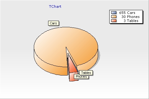

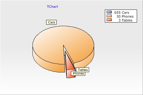

Here is what we are getting with your application:
Pie with TeeChart v2010 (GDI)
Pie with TeeChart v2010 (GDI+)
