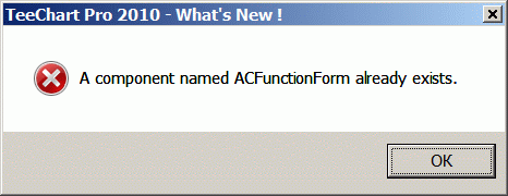

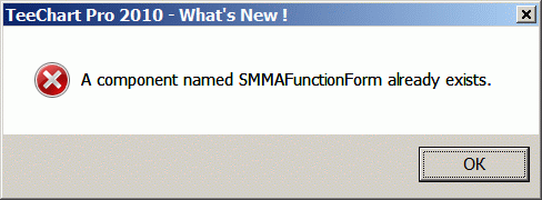

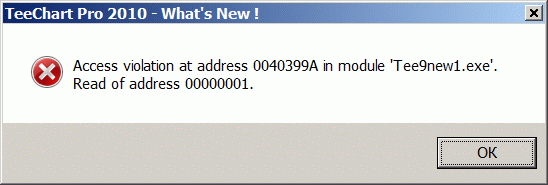

However, the application is still unstable and sometimes show unreproducible errors and AVs:
And after some of them the program remains in memory after closing.
AC(Acceleration/Deceleration) form
AR(Average True Rate) form
Smoothed Moving Average form

and some more:
Ternary series form
Alligator form
