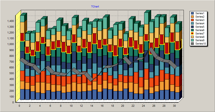

Re: Highlight series when mouse is over item in legend
Post by Yeray » Mon Mar 15, 2010 9:27 am
Hi Ed,
The most significant difference I can see between your picture and the demo I made is that your bars are stacked but with adding it and even using your code, I don't reproduce the "all-selected" problem. Here is the complete code I'm using that seems to work fine here:
uses series;
var FAntClickedIndex: Integer;
var i, j: Integer;
  for i:=0 to 8 do
    with Chart1.AddSeries(TBarSeries.Create(self)) as TBarSeries do
      for j:=0 to 30 do Add(random*100+100);
      Marks.Visible:=false;
      Color:=OperaPalette[i mod 12];
      MultiBar:=mbStacked;
  Chart1.AddSeries(TLineSeries.Create(self));
  Chart1[Chart1.SeriesCount-1].FillSampleValues();
  FAntClickedIndex:=-1;
procedure TForm1.Chart1MouseMove(Sender: TObject; Shift: TShiftState; X,
  Y: Integer);
  procedure ClearHighlightedSeries;
  var lSeries: TChartSeries;
    if (FAntClickedIndex >= 0) and (FAntClickedIndex < Chart1.SeriesCount) then
      lSeries := Chart1[FAntClickedIndex];
      lSeries.Pen.Color := clBlack;
      lSeries.Pen.Width := 1;
var
  lClickedIdx: Integer;
  lClickedIdx:= Chart1.Legend.Clicked(X,Y);
  if (lClickedIdx > -1) then
    if (FAntClickedIndex <> lClickedIdx) then
      lSeries := Chart1[lClickedIdx];
      lSeries.Pen.Width := 2;
      lSeries.Pen.Color:= clYellow;
      lSeries.Pen.Visible := True;
      FAntClickedIndex := lClickedIdx;
  end
  if (FAntClickedIndex > -1) then
And here is the result I get with TeeChart v8.06:
Is the code above giving the same result than me?
What TeeChart version are you using?

Finally got it. Had to copy the chart from the other version to this one. It is in the attached demo--I included the source code (from D2007, TChart Pro 8.04).
If you move your mouse over the "Series #5" caption in the legend, more than one series highlights.
What is causing this?

Hi TestAlways,
I've seen in the exe you've sent that moving the mouse over "Series #5" all the series seem to be selected. I've also seen that if you move the mouse over the other series in the legend, the series selected in the chart are more correct as more series you've been selected, and finally when you've selected all the series, all them work fine, even for "Series #5".
The problem could be in the index returned by the Chart1.Legend.Clicked(X,Y) call in the OnMouseMove event.
Then I compiled the project with the actual v8.06 and couldn't reproduce the problem. So the first I'd recommend would be to update the component to the latest maintenance release, if possible.
Another thing you could check would be adding the following statement in your OnMouseMove event, after the clicked call, to check the if the value returned is correct at any time:
  Chart1.Title.Text.Text:=IntToStr(lClickedIdx);
