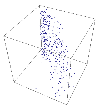

BACKGROUND: SPIN PLOTS
I'm trying to create a "spin" chart using TChart. A spin chart lets an analyst view a 3D scatter plot and spin it around by pitch, yaw and roll. Here is an animated GIF that is a good illustration:
macspin example.gif (140.35 KiB) Viewed 9997 times
With a modest number of points (up to 20 or 30, say), it would be desirable to be able to label each point. And that's where the challenge starts with TChart!!
