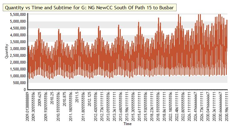

I am trying to format the x-axis labels in a simple line chart as '0.00' to produce for example 1.23 or 6767.22. Problem is the BottomAxis.AxisValuesFormat does not seem to be doing anything for this particular chart. It's strange because it works for other charts that I've created. The numbers on the x-axis are very long, e.g. 2009.0138888889 - do they have to be truncated? I thought the AxisValuesFormat would remove the need for that. I've tried '0.##', '#.##', everything. Also tried setting the BottomAxis.Increment to 0.01.
I've attached a screen cap to demonstrate.

Is it possible that you've entered your values with label and this label is what is shown in the bottom axis?
In that case, note that you are trying to format a string, not a double. To format it you need to convert your labels to a float, and then format them. And to do this you should use OnGetAxisLabel event. Here is an example:
var i: Integer;
  Chart1.View3D:=false;
  Chart1.Legend.Visible:=false;
  with Chart1.AddSeries(TBarSeries.Create(self)) do
    FillSampleValues(200);
    Marks.Visible:=false;
    for i:=0 to Count-1 do
      Labels.Labels[i]:=FloatToStr(Pi*(i+1));
  Chart1.Axes.Bottom.LabelsAngle:=90;
procedure TForm1.Chart1GetAxisLabel(Sender: TChartAxis;
  Series: TChartSeries; ValueIndex: Integer; var LabelText: String);
  if (Sender = Chart1.Axes.Bottom) then
    LabelText:=FormatFloat('#.##',StrToFloat(LabelText));

That solved it Yeray, once again thank-you!
