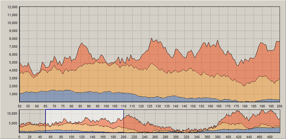

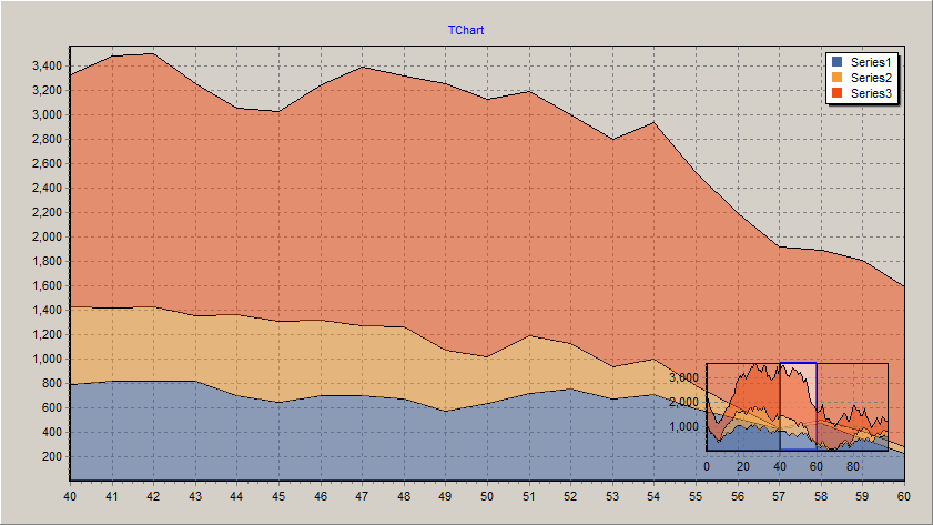

Re: Show a part of a chart in another
Post by Yeray » Thu Feb 25, 2010 3:02 pm
Hi Thorring,
As an update note that you can use two independent charts, but maybe the TSubChartTool gives you a more compact result.
Here it is a picture of what you can do:

It looks pretty cool but I still struggle with some minor problems. I am not sure about the ChartTool1Resized and where I find it? Further, I do not find the Draw property you are using but only one with parameters (canvas, Rect)? Will Repaint do it?
TSubChartTool looks cool as well, but it is not what I am looking for this time. I need to show up to 6 graphs in the chart with a lot of indications of ‘bad data areas’, spikes, rapid changes in data and so on. It will be too much to show the sub-chart in this mess of indications.

Hi Thorring,
Here you have a more complete example with TSubChartTool. Note that the ColorBand1Resized event is called when you resize the tool in the chart in the bottom.
