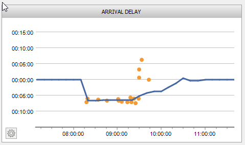

is there any news on this subject? We have a similar issue where having the value information delivered with the OnDrawAxisLabel callback would be really helpful:
We frequently display time values (in the sense of a period of time, or a duration) in a chart, such as a delay. See the image below for an example.
Delay Example.png (9.64 KiB) Viewed 52297 times
As you see, the delay values can obviously also get negative. Unfortunately, the left axis displays the negative times in the same way as positive ones and we have not found any way to change or customise this behaviour.
I was hoping to be able to solve this using the OnDrawAxisLabel callback, but without the tick value I have no clue on how to achieve that.
Thanks for your feedback,
Linus

thanks for your prompt answer. The problem of course is that when the initial LabelText denotes a positive value (as in my screenshot), the temp conversion into a TDatetime won't help.
Even when adjusting the DateTimeFormat of the left axis to a fully qualified Date/Time format (such as 'dd/MM/yyyy hh:mm:ss'), it won't properly work, at least for values between -1 and 0. I realise that the problem originates from Delphi's DateTimeToString function.
In case changing the existing callback is problematic due to compatibility reasons, an alternative might be to provide an additional one, such as shown below?
