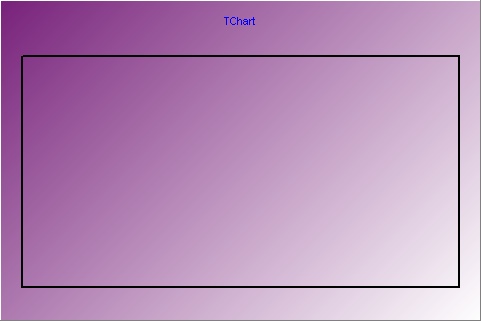

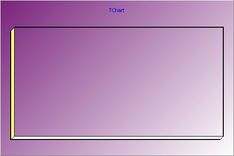

2. It works fine for me here using this code:
uses TeCanvas, TeeJPEG;
procedure TForm4.FormCreate(Sender: TObject);
  Chart1.Gradient.Visible := True;
  Chart1.Gradient.StartColor := RGB(120, 34, 123); // Some colour
  Chart1.Gradient.EndColor := $FFFFFF; // White
  Chart1.Gradient.Direction:= gdDiagonalDown;
  Chart1.View3D:=false;
That's what I get in 2D and 3D using our latest v8 sources:
2D chart
3D chart
Which Teechart version are you using? Can you post an image of what you get?
