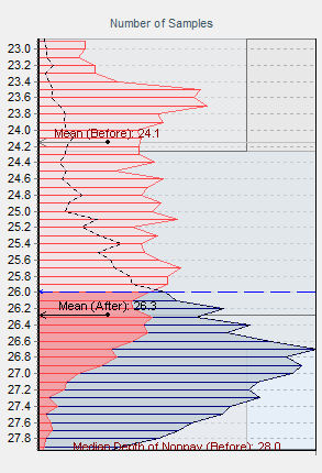

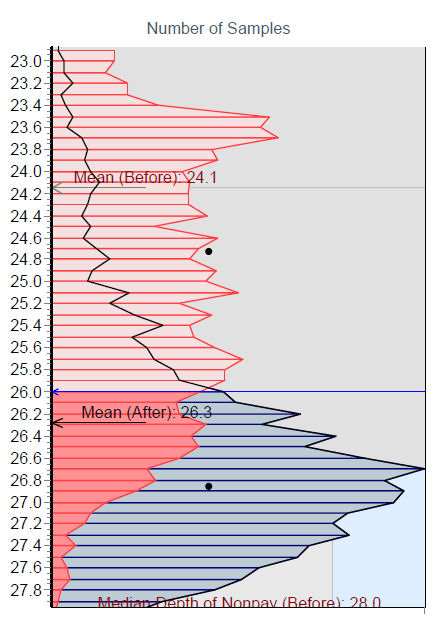

I am using a TChart component in a C++ Builder 2009 project. The chart has a about 10 series in it. A couple horizontal line series, a few shape series, and a couple arrow series. I also do a small amount of straight drawing to the canvas. Please see the attached files to see the bugs?/differences I am getting. Here are the differences I am seeing:
1) The print loses the transparency. This isn't a huge problem, but it doesn't do it.
2) The arrow series base marks are nowhere near the arrow line.
3) No dashed or dotted lines.
Are these options I am not setting correctly, or bugs?

Thanks for the info and links on 1 and 3. As for 2, please look at the black dots on the top chart. On the bottom chart they are attached to the back end of the arrows. It looks like printing issues with the Arrow Chart series.Narcís wrote:Hi John,
1. Transparency is not supported on printing. It's on our wish list to be considered for further releases. In the meantime you can do what Pep suggested here.
2. I'm not sure about which is the exact problem here. Could you please give us some more details?
3. This issue is mentioned in the Printing Better article I posted here.
John
