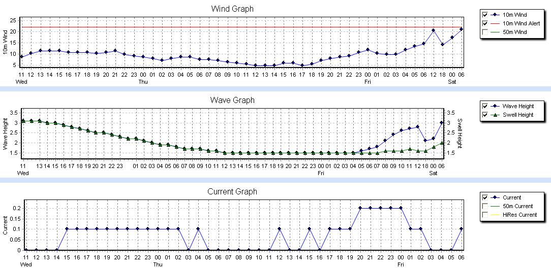

I have multiple charts positioned above each other and need to align both the left and right axes i.e. fix the width of all charts regardless of data present. Some charts have multiple axes i.e. labels on right, while others are simple charts with labels/ticks only on left axis.
The bottom axes is the same for all charts, TDateTime, and I want to be able to show a fixed time period e.g. 72hrs, regardless of whether there is data for that time. I have enclosed an image of the existing. To sum up:
1) How do I fix the widths for multiple charts
2) How do I fix the bottom axis data to display a fixed time period regardless of data present

Hi darcy,
1. Take a look at the following example that shows how you could set the margins to have two charts aligned:
2. Have you tried with the axis Increment property?
Series1.FillSampleValues(100);
Series2.FillSampleValues(200);
Series1.VertAxis:=aBothVertAxis;
LeftAlignCharts([Chart1,Chart2],100,600);
Chart1.Draw;
Chart2.Draw;
RightAlignCharts([Chart1,Chart2],100);

Thanks for the reply.
1) I have been able to force the charts to be aligned correctly using CustomChartRect = true and defining the rect size relevant to the parent control. RESOLVED
2) I still am having issues forcing the charts to be fixed to a set time period for the x-axis e.g. 72hrs, despite the presence of data. The increment works fine but will not plot markers along the x-axis after the last data value. What I mean is if I add a dummy data point at the very last X-axis point it will behave as I want. I want the time increments to increase to 72hrs despite the presence of data.

Then I think that the only solution would be using custom labels like in the demo at All features/Welcome !/Axes/Labels/Custom Labels. You can clear all the labels from the bottom axis and add the labels you wish and with the text you want.
