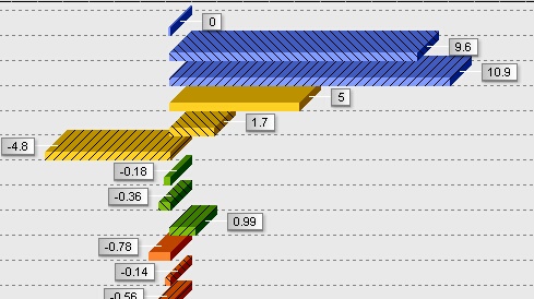

Is it at all possible, to toggle the chart between Horizontal Bar, and Bar, with the same data, but differently orientated, according to user preference.
If possible, how do I achieve this in code?
I want to rotate this from HorizontalBar to Bar.

Hi Doogie,
Yes, you could use ChangeSeriesType function. For example:
var i: Integer;
    tmp: TChartSeries;
    tmp:=Chart1[i];
    if Chart1[i] is THorizBarSeries then ChangeSeriesType(tmp,TBarSeries)
    else ChangeSeriesType(tmp,THorizBarSeries);
