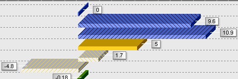

This gives you three bars with the 2nd and 3rd with a pattern, but without a fill color.
The first bar in the attachment is blue, and by setting the second bars properties in the IDE to Format Rectangle, Color Blue -> then Patttern, then select diagonal, and change both the color and background to blue aswell, I get the desired effect.
But the next two, I don't set in the IDE, I want to set this programatically, but IF I set background color, no effect.
How do I get this right in code?
See attachment

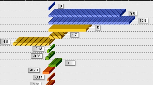

Ok.. a bit wierd, but you have to set both Brush.Color and Brush.BackColor
    i := 0;
    While i < 34 do
    DBChartBLUP.Series[i+1].SeriesColor := DBChartBLUP.Series[i].SeriesColor;
    DBChartBLUP.Series[i+1].Brush.BackColor := DBChartBLUP.Series[i].SeriesColor;
    DBChartBLUP.Series[i+1].Brush.Color := DBChartBLUP.Series[i].SeriesColor;
    DBChartBLUP.Series[i+1].Brush.Style := bsFDiagonal;
    DBChartBLUP.Series[i+2].SeriesColor := DBChartBLUP.Series[i].SeriesColor;
    DBChartBLUP.Series[i+2].Brush.BackColor := DBChartBLUP.Series[i].SeriesColor;
    DBChartBLUP.Series[i+2].Brush.Color := DBChartBLUP.Series[i].SeriesColor;
    DBChartBLUP.Series[i+2].Brush.Style := bsBDiagonal;
    i := i + 3;
See attachment for final result.
