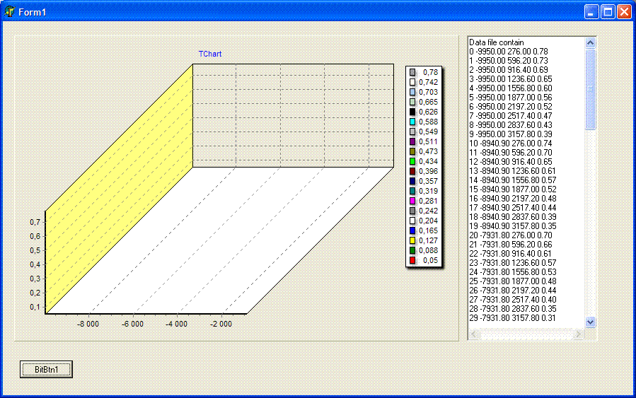

I currently have a problem with drawing 3D contour/surface.
I try to read a file which contains 3 colums: x,y and z. While reading (using readln(textfile,x,y,z), I put the data into a Tcontour as follows:
if OpenDialog1.execute then begin
AssignFile(Datafile,OpenDialog1.filename);
Reset(Datafile);
Series1.clear; // Series1 is a TContour
while not(eof(Datafile)) do begin
Readln(Datafile,x,y,z);
Series1.AddXYZ(x,z,z,'',clTeeColor); // add point to the contour
Memo1.Lines.Add(Num2Str(cnt,0,0)+' '+Num2Str(x,2,2) + ' ' + Num2Str(y,2,2) +' ' +Num2Str(z,2,2)); // add values to a TMemo for visualization
end; // end of eof()
CloseFile(Datafile);
The problem is no contour appears on the chart, although the axes correspond to the x and y extents, and the 20 levels legend corresponds to the z values. (please see the attached GIF image).

I have just tried to add Series1.IrregularGrid:=true command but nothing changes (Series1 is a TContourSeries).
I attached my project here so that you can have a look in it. When you launch the project, there are some contours due to initialization. Then you click on the Plot data from file button and load the contour1 file. You will get the loaded data on the right of the window, and the Tcontour plot on the left, but there is no contour line for the moment.

According to the explanation that Narcis pointed to you of how the contour series should be populated, I think that adding your values as you do is not correct:
On the other hand, both the following lines can be applied successfully in your code, giving different results:
or...
Series1.AddXYZ(x,z,z,'',clTeeColor); //incorrect input
Series1.AddXYZ(x,z,y,'',clTeeColor); //correct input
Series1.AddXYZ(y,z,x,'',clTeeColor); //correct input

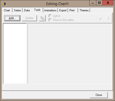

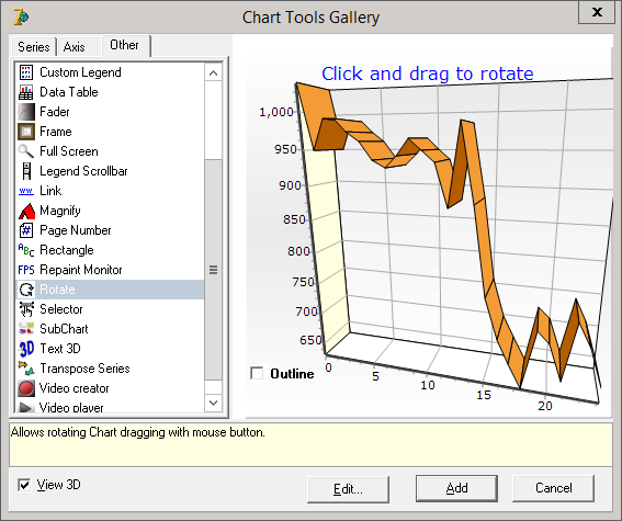

Finally, you can also add it at design time. You can double-click on a TChart to open the editor, then you can navigate to the "Tools" tab.
You can click on the "Add..." button to open the tools gallery, select the "Rotate" tool in the "Other" tab, and click "Add".
