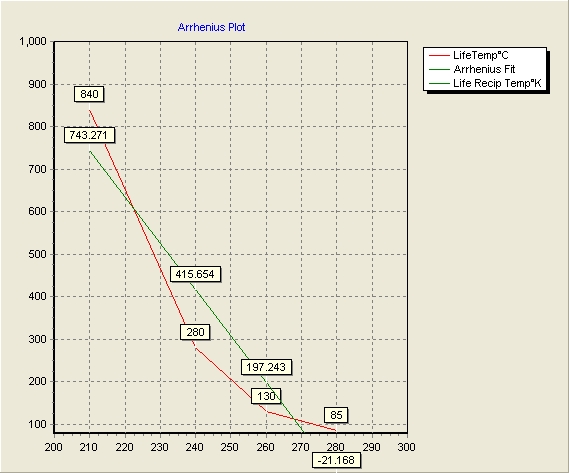

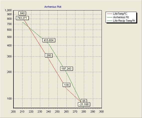

Now I'm curious about the shape of the parabolic fit. The curve fitter apparently did not notice the inverted nature of the parabola traced by this dataset. One would expect an inverted parabola in the fitted curve as well.

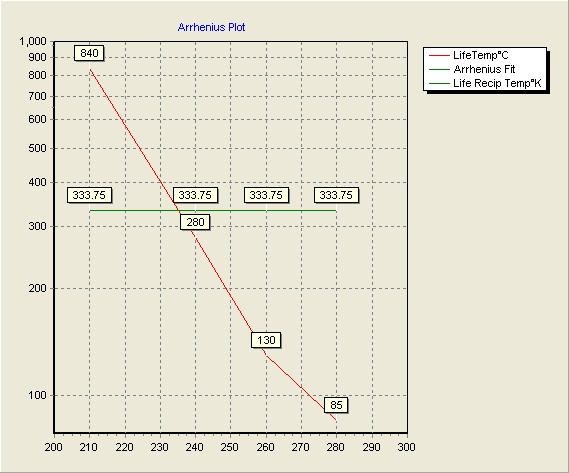

I went to a linear Y-axis again, tried a 2nd degree polynomial, and that gave a straight line. Also attached
If any of this has been corrected in v. 8, please let me know.

- Second degree fit to linear y axis
- LinearY-2ndDegree.jpg (94.55 KiB) Viewed 26200 times
- Results of second-degree polynomial fit
- PolyDegree2.jpg (94.09 KiB) Viewed 26107 times
- Results of first-degree polynomial fit
- PolyDegree1.jpg (91.68 KiB) Viewed 26111 times

I think it works in the same way in v8 but I don't think that's a bug.
First of all note that changing the Y axis from linear to logarithmic, it affects the axis, but not the series' values neither the curve fitting calculations so a line that describes an inverted parabola, changing the Y axis to logarithmic can change the line to describe a different parabola.
And to understand how that function works, please take a look at the following topics:
http://www.teechart.net/support/viewtop ... 77&p=17447
http://www.teechart.net/support/viewtop ... f=3&t=5812
http://www.teechart.net/support/viewtop ... 777#p42818

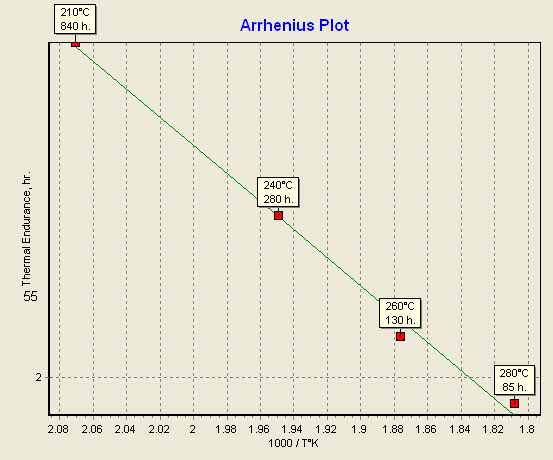

A bit of progress. I created a custom axis. See AfterDraw event. I now have exactly one tic on my vertical log axis. In dmChartUtils.pas you can see some code for writing tics at 1,2,5,etc. But maybe you have a better, simpler method.
At the end of Chart1AfterDraw() I added one new line of code. I included existing code to show you where the new line was added:
yMin := ChartCommon.GetRoundLog( MinYValue, false );
yMax := ChartCommon.GetRoundLog( MaxYValue, true )
With NewAxis do begin
DrawAxisLabel( 75, 300, 0, '55' );
75 and 300 appear to be pixels from top left of chart panel. After adding that line, if you press "Convert", the number 55 will show up. If you press "Linear Fit", the left side of chart moves left, and 55 is closer to where it should be. See screen shot attached.
Can you relate the pixels of the chart to the reference of the panel, so that I can efficiently program the axis labels. And then there is the shift when I press "Linear Fit". That is probably the custom axis, which probably means I need to do the drawing later? Or maybe you have a better way of doing all of this? We also need grid lines for the y axis.
Hope you see the number 2 axis label near bottom of vertical axis. How is that written, and can that method be overridden with the scheme shown at bottom of block, commented, together with ChartCommon.GetNextTic()"? But I am hoping that you can show me an easier method, either with v. 5 or v. 8. If v. 8, could you send some documentation.
Call to your procedure is commented out in the AfterDraw method.
The runtime chart editor does not appear to change any properties on my custom Y axis. Maybe that is expected behavior, or some setting is wrong?
Thanks for your help in this.

- CustomDraw.jpg (47.87 KiB) Viewed 26011 times
