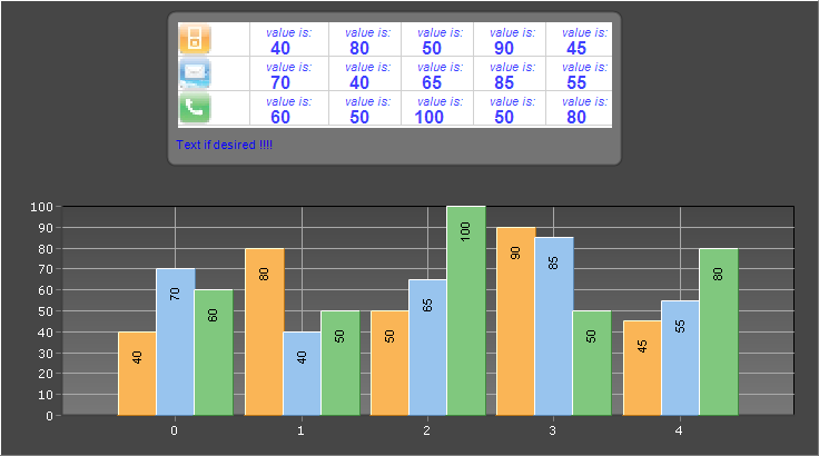

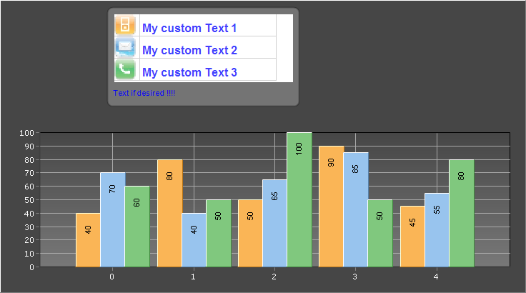

With TeeChart v2010 there is another possibility: the Custom Legend.
You can find an example about it in the features demo "What's New ?\Welcome !\New Chart Tools\Custom Legend"
Custom Legend.png (20.76 KiB) Viewed 5214 times
Custom Legend 2.png (21.68 KiB) Viewed 5195 times
