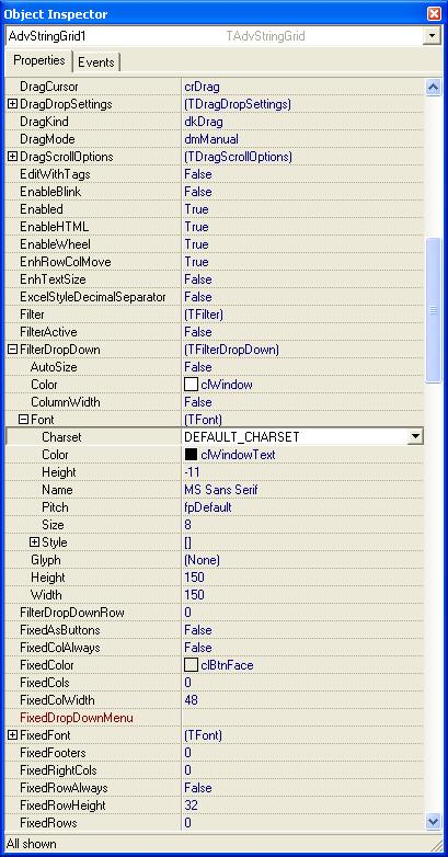

I just upgraded TeeChart from V7.04 to to 8.06 for Delphi 6. I try to compile an existing mature application and now get an error that a FilterDropDown property does not exist (see screen capture).

The project builds and runs successfully on a different computer that is still running Steema TeeChart Version 7.04 for Delphi 6
The AdvStringGrid1 shows a Version of 4.6.1.0 in the Object Inspector (shows the same on the V7.04 system too)
I have uninstalled and reinstalled TeeChart with no change. The program won't start
Any ideas?

Hi Track1,
TAdvStringGrid is not a Steema component. Please check that this component is correctly installed in your machine.

Ooops!
