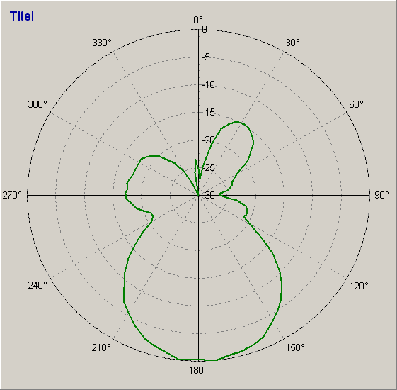

This png shows everything ok,

Jubar wrote:Here the series is shown black, it should have been green
I could reproduce it printing as pdf with PDF-Writter from CutePDF but not using TeeSaveToPDFFile with the Button1 at the code I posted above. Have you tried wit it?
