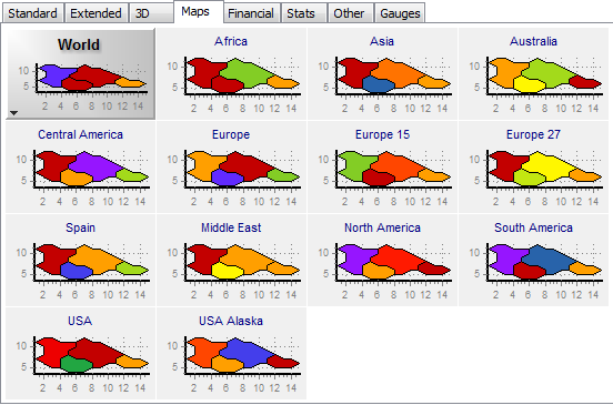

I have one more question: is it possible to add maps i the Dialog (see attachment)?
My application is distibuted in Italy and I would like to have something like you have for spain, ideally with different groupings (by region and by province).
I use TeeChart with ReportBuilder, so I leave my users to create their own reports, so of course a simple procedure would be better!
So my original post question can be translated in a more practical one:
1) how do I create an Italy map?
2) how can I publish it (or give the users a simple way to load from file into the report)?
- World Series Dialog
- WorldSeries.png (21.75 KiB) Viewed 13086 times

Re: TWorldSeries: using new maps
Hi Bruce,
I'm not sure to understand what does it mean "populate" here. The map is loaded from a resource or from a shape file that contains a list of polygons.Brace wrote:1) considering an existing map in TWorldSeries (like Europe 15). how do I popuplate the map? Imagine I have a table with country code on one field and a number on another field.
It is possible to load the map from the shp but I'm afraid that not through the editor. Instead of this, I think you could use for example a combobox to show the list of possible maps and load the chose shp with a button.Brace wrote:2) Is it possible to load shp and shx files from the TChart Editor? I say this because I am using this with Report Builder so I would like to give my end user the possibility to load any kind of map.
Here it is:Brace wrote:Can you provide a sample application for achieveing that result?
