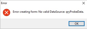

But when i tried to open the form that uses the tqrchart then it errors. See attached image.
This also happens when i made a new app with just the chart on it.

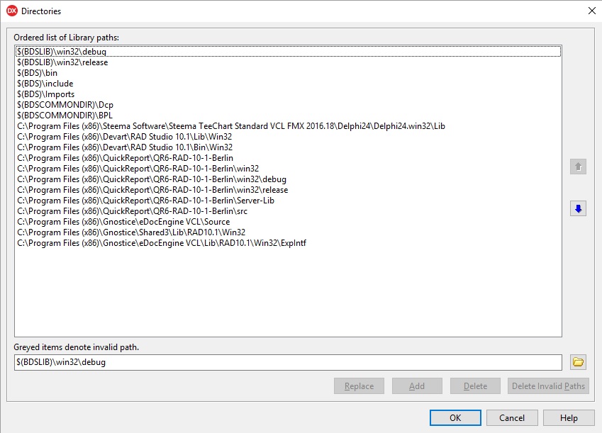

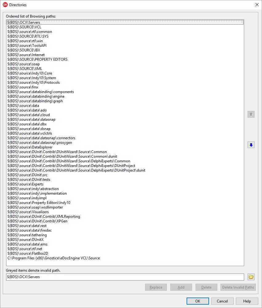

I have attached a couple of screen shots of the options library section, is there anything that looks like is missing.

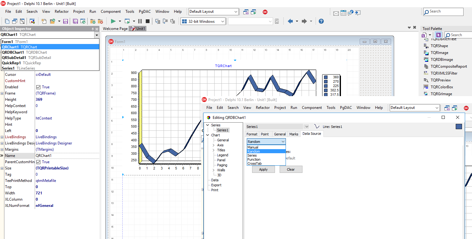

I tried a new form and put a quick report frame on it plus a sub detail band and a chart. As you can see it has added the qrdbchart plus the qrchart when i put a chart on the page. But when add the line series in it's datasource it is missing the datasource option from the drop down. the link between the 2 charts does not seem to be there.

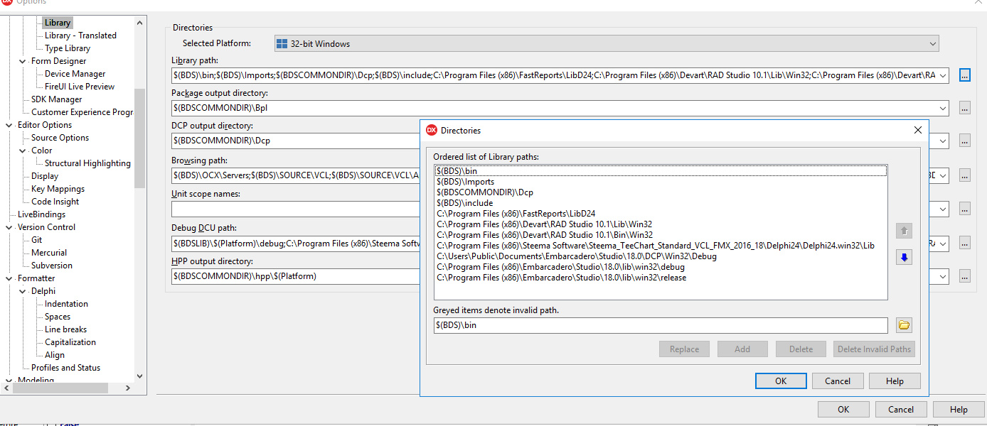

Hope this gives more info. I realise this just works for every body but not for me.

I also unistalled every thing again plus 3rtd Party components, purged the registry of any links and so it was a complete fresh install with the defaults in place.

Have been flat out upgrading other apps so havent haven't tried that approach yet. Bu have no choice but to do so as my last ditch attempt failed.
I recently installed on to a fresh Win10 pc that has never had any developing programs on it, Berlin 10 with update 1.
All the 3rd party programs pgDac, Quick Report 6 Pro, Gnostice, including teechart installed correctly with no problems and all work as they should.
So now i try the TQRChart install. The quick report was changed to QRWRunDXE10_1_W64 that was all that was needed. Both the Tee and the DCL compiled correctly with no errors.
I copied the files to the appropriate locations, when i tried to add the package that failed. with the usual specific module not found. Library paths for all units/dcp/bpl where availbale.
I removed all the files from the relevant locations where i had put them and added a file path in the library to the compiled files location.
I was able then to add the package from that location. No Errors at that point.
I created a new app and on there i put a quick report and subdetail band and added a chart. no problesm so far until i select a datasource from the series section and find that the dataset, single record was missing.
The fact this is a fresh pc with no hang ups from old software etc.. makes me wonder.
Delphi was installed as is, i did not change any options it was all stock standard.

Hello Carl,
I tried it again a couple of times and I ended reproducing "the specified module could not be found" problem.
Your solution of using $(BDSCOMMONDIR)\Bpl didn't work for me.
I also tried to completely uninstall and reinstall the IDE. This didn't work either.
Then I thought there must be something that isn't correctly uninstalled and I launched the IDE with an option to reset the registry to the defaults:
http://docwiki.embarcadero.com/RADStudi ... nd_Options
Then I could load the DclTee9QR6D24.bpl without problems from $(BDS)\bin again with these packages:
And I can see the "single record" option without problems.
bds.exe -cleanregistryide
