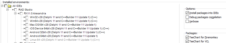

I am trying to install in RadStudio 11 using TeeRecompile.exe.
I also have RadStudio 10.4 installed.
For RX11.0 Alexandria TeeRecompile does not show Delphi under installed environments. Only C++ is listed.
For RX10.4 Sydney all environments are listed and work.
RadStudio 11 is installed with Delphi working fine. I had compiled the last release of TChart for RadStudio 11 and it was already working.
How can I fix the issue?

JaMit
Joined: Tue Mar 15, 2022 12:00 am
Re: TeeChart VCL/FMX v2022 [03 FEB 2022] RELEASE 2022.34.220203
Post by JaMit » Fri Mar 18, 2022 6:03 pm
Hello Marc,
thanks for the feedback.
I tried removing Delphi in RadStudio and adding it back. Didn't solve the problem.
Then I completely uninstalled RadStudio 11 and reinstalled it.
No change, Delphi still not visible in TeeRecompile.

Post by Marc » Thu Mar 24, 2022 2:33 pm
This issue resolved. TeeRecompile's environment titles are of this format for Delphi & C++Builder:
The (C++) parameter at the end of the line gives the impression that support is for C++ only. That is not the case, successful conclusion of the run will install packages to the IDE for both Delphi & C++Builder. We will look to remove that end-of-line for future updates as it transmits the wrong impression.
