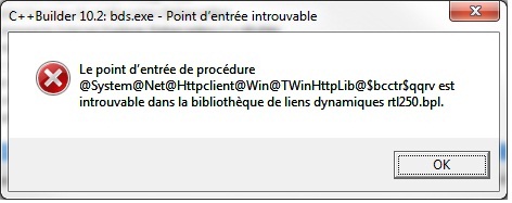

Even by using the last .23 version of Teechart Pro, I have some issues on the installation, the following error appear at IDE startup (C++ builder 10.2 Update 1). Do you have any ideas ?

TeeChart v2017.23 supports and requires the Release 2 of RAD Studio Tokyo.
