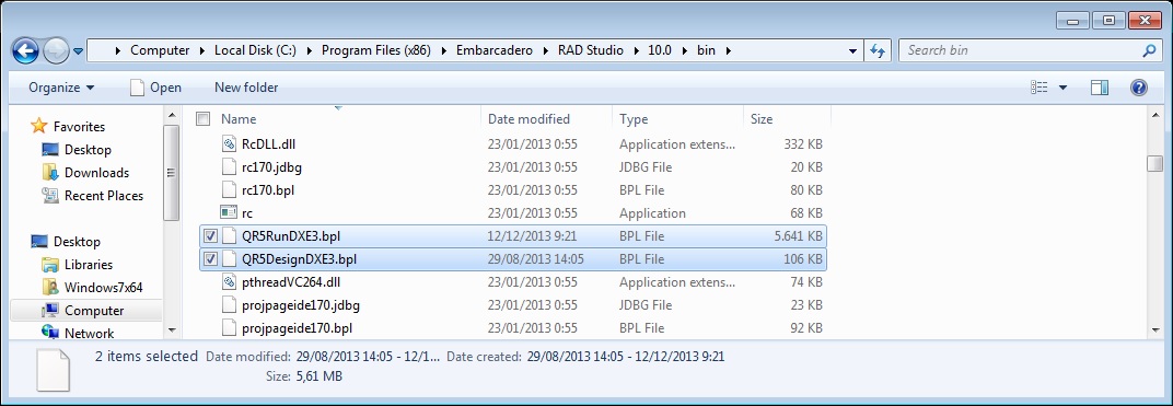

I would like inform you that I have installed the Quick Report files XE3 for Win32 (QR505CBXE3.EXE) from the Quick Report Download page and the files are installed for me after run the QR505CBXE3.exe are QR5RunDXE3.bpl and QR5DesignDXE3.bpl as you can see in the image below:
And the TeeChart packages for Quick Report works fine in Rad Studio XE3 C++Builder
I would like suggest you uninstall all the Quick Report files are you installed and remove the QR505CBXE3.exe from your machine. Then download again the QR505 installer from the Quick Report WebSite and install QR again. Could you confirm us your results?
Also, if you want you can update the QR version and use the Quick Report 506 instead of Quick Report 505

Thank you, it works.
I redownloaded QR505CBXE3.exe from QuickReport website, and indeed, it was twice the size of the setup we had on our server...
Eveything works now, thank you !
