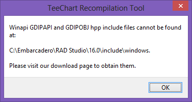

I have uninstalled everything and have started Delphi XE8 from scratch. When I installed TChart Pro 2015, I got the following error message:
I cannot find these files anywhere. It would do a lot for my sanity to be able to locate these files on your site as the message said, so if someone could give me a kick in the right direction, it would be appreciated.

Rick Hillier wrote:When I installed TChart Pro 2015, I got the following error message:
In the latest release announce in this forum you can see this:
Narcís wrote: ATTENTION: For those users with problems with missing GDIPOBJ & GDIPAPI headers, you can download them here.

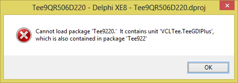

I also tried installing the precompiled packages that came in the zip file that was provided.
I get this error when installing it:
All I have done is install Delphi XE8, QReport Pro 5.06, the InfoPower suite, DBISAM (database) and TeeChart Pro.

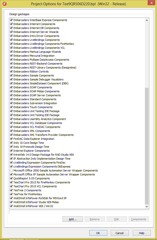

Here is the bottom of the list of Delphi packages installed (the top consists of all of the basic packages that come with Delphi):
I don't see sign of the standard component installed.

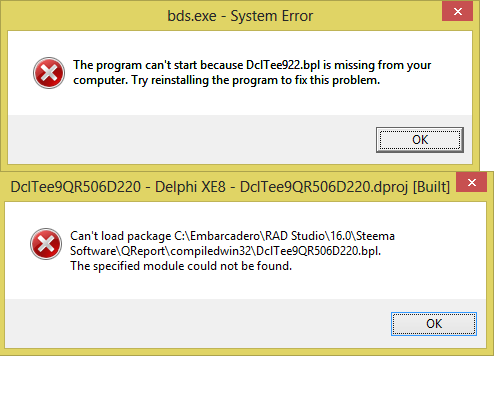

After some fiddling around, I managed to get the packages to compile, however, when I go to install the design time package, I get these errors:
I am pretty sure I have the library search path set up correctly.

Rick Hillier wrote:I get this error when installing it:
This is because the TeeChart Lite/Standard version that is shipped with the IDE is still being loaded.
It can be loaded because:
- It hasn't been correctly uninstalled when installing the Pro version.
- It is loaded by some 3rd party tool embedding it.
- The TQRChart packages you are installing were compiled for it.
Rick Hillier wrote:All I have done is install Delphi XE8, QReport Pro 5.06, the InfoPower suite, DBISAM (database) and TeeChart Pro.
I'm not sure if any of these 3rd party tools include any component embedding TeeChart Lite/Standard. I'd try unselecting all them from the list of packages.
Rick Hillier wrote:Here is the bottom of the list of Delphi packages installed (the top consists of all of the basic packages that come with Delphi):
I see lots of 3rd party components. Try unselecting them to see if you can add the TQRChart precompiled packages (or those compiled for you).
Rick Hillier wrote:After some fiddling around, I managed to get the packages to compile, however, when I go to install the design time package, I get these errors:
Have you changed the references in DclTee9QR5D22.dpk?
Note the TeeChart Pro design time package for XE8 is called DclTeePro922.bpl.
DclTee922.bpl is the package for the Standard commercial version. Both packages should be in your TeeChart Pro installation, in the "\Delphi22\Delphi22.win32\Bin" folder but only the Dcl*Pro*.bpl should be referenced in DclTee9QR5D*.dpk if you are using TeeChart Pro.
