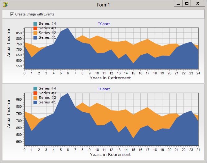

This is what I get with v2014.10:

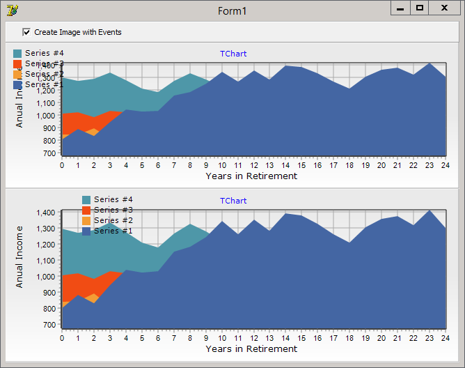

This is what I get with the actual sources (and also with the sources I sent you the 13th March):
Aren't you getting this with the sources from the 13th March?

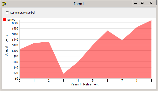

TestAlways wrote:#2: It actually has an old "bug" (may you are not calling it that) that I raised some years ago. If the area series is transparent, then the symbol for the series must be custom drawn otherwise it does not match the color of the series.
We found the cause of this and modified the sources so the next version will show the transparency in the symbol if the series has it.
However, it would be helpful if you could tell us where did you report it. I can't find it either here nor in the tracker. Just to look for the trace of the issue/ticket.

Yes. And there are two images of concern--the chart image and the bitmap created. They are both wrong. Here is a an image--note the legend in the second one.
I'm a bit confused. When I run the project you attached in this post I get the images you can see in the reply to that post. However, the images you just posted seem to be from the project of the beginning of the thread, that we thought were fixed with March 13th sources and the solution Narcís proposed here.
So I'm not sure to understand if the project you attached in this post was to still reproduce the problem of the legend position/size, the transparency in the legend symbol, or both (I reproduced the transparency problem in the symbol legend with the latest sources but not the first one). So I'm not sure to understand what exact problem do you still reproduce with the March 13th sources.
Please, try to summarize the problem you are still reproducing with the latest sources you have so I can get back on track :P

Thanks, I've copied the ticket from the old system to the new tracker so you can follow it's status:
http://bugs.teechart.net/show_bug.cgi?id=663
We've applied the fix but still doubting if this is the best solution: We agree the legend symbol should look as similar as possible to the series, but while a transparency may look nice inside the ChartRect, it may look bad out of it depending on the background color/gradient/image you may have.

If I run the project as it is with the latest sources, this is what I get:
But, if I uncomment the second Draw:
  Chart1.Draw();
  Chart1.Draw();
Or if I use Draw+Repaint:
  Chart1.Draw();
  Chart1.Repaint();
Then, this is what I get:
Isn't this what you'd like to get?
Isn't this what you get with March 13th sources?

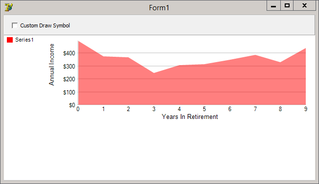

However, if I apply it to the project you attached above, I don't get the error any more, but I get a wrong Legend again.
This happens because the Draw we forced doesn't know what size will be applied later in the TeeCreateBitmap. It can be easily fixed substituting the lChart.Draw by this:
lChart.Draw(lChart.Canvas.ReferenceCanvas, lRect);
I even only need one call to get a correct Legend.
