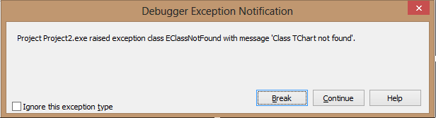

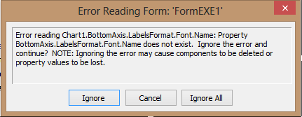

I just noticed your last post a couple of weeks ago. Your posts do not give me an automatic email notice and I really had no reason to expect anything until the last update came out. When it came out I rechecked my posts.
I waited to today to do anything as this is the first time I was able to get to the new update. I figured this would be a good starting point. Unfortunately, I was not able to use the update as it comes up with a missing entry point when I start the IDE after installation. So I reverted back to the only version I have been able to use (XE4 Beta from April 2013).
I decided to try your revised test case. I downloaded the test case and created a new directory. I loaded the test case into the new location. I started the IDE and opened the project. When it compiled, it asked for the 919 files and I substituted the 918 versions. When it went to link, it was looking for the 919 lib. This is not unusual in C++ and I took my usual approach to fix it. I closed the IDE and opened the project files (both of them) in Notepad and replaced the 919 references with 918, and then saved the files. (This is a standard procedure for us C++ people as not all the references in the project files are updated by Embarcadero software, and I have to do this for each project file when I move to a new Embarcadero release. This is one of the reasons I do not like to go to new releases).
I started the IDE and selected the revised test project. When it is loading the project, I now get an error (Form Error). I ignore all of the messages and the project opens. I then did a build of the DLL and EXE. When I run the EXE, I get the TChart not found error (attached). Bottom line is your test case does not run in my current environment. I do not know if it fails on the latest, and I would like to know that piece of information before proceeding.
As for XE5. I have no reason to move to it as there is nothing in the C++ stuff that pertains to me. I have looked at the Embarcadero Roadmap, and I see nothing in there for XE6 that pertains to my development environment. The reality is, until they do 64bit packages (in C++), there is really no reason for me to move forward in the Embarcadero releases as I am stuck on 32bit.
Let me finish with this. I am really curious as to why your test case works for you on XE5 and not work for me on XE4 (with XE4 Beta). I am hoping it has something to do with your latest update, but I have no way to check this out. I think the best way to attack this is to get your latest update running on XE4 for me and then I can test it out. Then, if the update does not work, then I would have to seriously think about testing XE5 or maybe XE6. The other issue I face is that I paid for a year's worth of maintenance from Steema, and I have yet to be able to use any of the updates during that period of time. My maintenance plan will expire in June and I am not sure I will be in any different position with this by then.
Needless to say, I have become very frustrated with situation. I am in a situation that the way forward is uncertain, and quite possibly impossible.
- TChart Not Found.png (13.94 KiB) Viewed 59902 times
- Form Error.png (16.28 KiB) Viewed 59889 times
Re: C++ Faults when a TChartListBox is used in a DLL.
Regarding your technical problem, I could run your last test case in XE4 using our current sources. I'm going to send an email with the URL to download them so that you can check if the problem is solved at your end.
I'm sorry to hear about your experience. We will investigate what the problem is.rgsolutions wrote:I just noticed your last post a couple of weeks ago. Your posts do not give me an automatic email notice and I really had no reason to expect anything until the last update came out. When it came out I rechecked my posts.
Replacing 919 references for 918 I got the "Class TChart not found" error too in XE4. We will investigate this as well.I think the best way to attack this is to get your latest update running on XE4 for me and then I can test it out.
