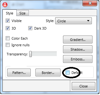

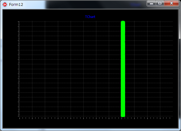

Hello Narcís,
I just tried to check the "Default" of Pointer setting form,
then it seems going worked.
But even I unchecked "Default" of Pointer ,
the problem can't be reproduced... I am confused!
Anyway, would you please tell me how to set "Default" of Pointer
to TRUE by code?

Re: About Horizontal Point Line
Post by Narcís » Wed Nov 13, 2013 10:54 am
Hi elmec,
The design of this form (TeePoEdi) has changed for the upcoming version. I think the checkbox you mention does this:
    ThePointer.Color:=clTeeColor;
    ThePointer.Pen.Color:=clTeeColor;
What makes a difference in your project is setting Pointer.Pen.Color:
	Series2->Pointer->Pen->Color=clTeeColor;

Post by elmec » Wed Nov 13, 2013 11:13 am
Hello Narcís,
By adding the following two lines, it seems that the problem has been solved...
Post by Narcís » Wed Nov 13, 2013 11:15 am
Hi elmec,
Yes, as I have added in my last reply, Pointer.Pen.Color makes the difference. That only works with psRectangle though, still fails with psSmallDot.
