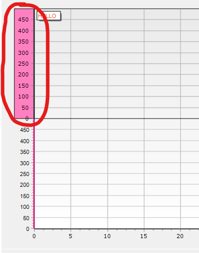

Hello.
How to catch event when axis or axis labels are clicked (labels back rectangle). Is there any way to calculate this area coordinates?
Zrzut ekranu 2025-08-07 111703.png (15.68 KiB) Viewed 390 times

Code like this would do it:
procedure TForm5.Chart1AfterDraw(Sender: TObject);
  Chart1.canvas.TextOut(10,3,MyMessage);
procedure TForm5.Chart1ClickAxis(Sender: TCustomChart; Axis: TChartAxis;
  Button: TMouseButton; Shift: TShiftState; X, Y: Integer);
var topThreshold,bottomThreshold,clickValue : Double;
  topThreshold := 400;
  bottomThreshold := 200;
  clickValue := Axis.CalcPosPoint(Y);
  if (not Axis.horizontal) then
  Begin
    if (clickValue>bottomThreshold) and (clickValue<topThreshold) then
      MyMessage := 'In range: ' +  FloatToStr(Axis.CalcPosPoint(Y))
      MyMessage := 'Out of range: ' +  FloatToStr(Axis.CalcPosPoint(Y));
    Chart1.Repaint;
If you want to draw the rectangle then you can use the Axis.CalcPosValue method in unison with Axis.CalcPosPoint to define the bounds of the rectangle.
This tutorial contains further information on custom drawing:
https://www.steema.com/docs/teechart/vc ... rial13.htm

This is only partial solution, bacause ClickAxis event is fired only when axis line is clicked, not labels or whole marked area.

Extrapolate the code, there are several ways in. For example, use the OnMouseUp event that has x,y too.
procedure TForm5.Chart1MouseUp(Sender: TObject; Button: TMouseButton;
  //check x,y location against your target rectangle
Marc Meumann

here's an example rectangle:
var rect : TRect;
    leftPos, topPos, bottomPos : Integer;
  leftPos := Chart1.LeftAxis.PosAxis - Chart1.LeftAxis.MaxLabelsWidth - Chart1.LeftAxis.TickLength - 2;
  topPos := Chart1.LeftAxis.CalcYPosValue(Chart1.LeftAxis.Maximum);
  bottomPos := Chart1.LeftAxis.CalcYPosValue(Chart1.LeftAxis.Minimum+((Chart1.LeftAxis.Maximum-Chart1.LeftAxis.Minimum)/2));
  rect := TRect.Create( leftPos ,topPos,Chart1.LeftAxis.PosAxis,bottomPos);
  Chart1.Canvas.Brush.Style := TBrushStyle.bsClear;
  Chart1.Canvas.Pen.Color := clRed;
  Chart1.Canvas.Rectangle(rect);

Thank You for all answers. I found yet another option, in my opinion a little bit cleaner:
void __fastcall TFormMain::Chart1MouseDown(TObject *Sender, TMouseButton Button, TShiftState Shift,
          int X, int Y)
    TRect rect( Chart1->Axes->Left->Shape->ShapeBounds.Left,
                Chart1->Axes->Left->Shape->ShapeBounds.Top,
                Chart1->Axes->Left->Shape->ShapeBounds.Right,
                Chart1->Axes->Left->Shape->ShapeBounds.Bottom );
    if( rect.Contains(TPoint(X,Y)) ) {
        DEBUG_FUNC("Succesfull CLICK!\n");

Post by Marc » Fri Aug 08, 2025 7:54 am
Looks good. Thanks for the feedback.
