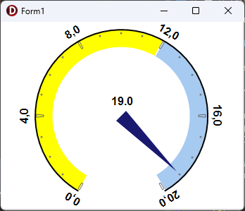

Here is my example:
uses Chart, TeEngine, TeeCircularGauge;
var Chart1: TChart;
  Chart1:=TChart.Create(Self);
  with Chart1 do
    Parent:=Self;
    Align:=alClient;
    Color:=clWhite;
    Gradient.Visible:=False;
    Walls.Back.Color:=clWhite;
    Legend.Hide;
    View3D:=False;
    with TCircularGauge(AddSeries(TCircularGauge)) do
      Frame.Hide;
      EndPoint.Hide;
      Center.Hide;
      Hand.Shadow.Hide;
      Hand.Gradient.Visible:=False;
      Hand.Color:=$701919;
      Hand.Distance:=0;
      Hand.HorizSize:=10;
      Hand.Style:=psTriangle;
      Hand.Offset:=100;
      Axis.Texts.MarginToAxis:=30;
      for var i:=0 to Ranges.Count-1 do
        Ranges[i].Format.Position:=0;
        Ranges[i].Format.Size:=25;
        Ranges[i].Format.Gradient.Visible:=False;
        Ranges[i].Format.Spiralled:=False;
      Ranges[0].EndValue:=12;
      Ranges[1].StartValue:=12;
      Ranges[1].EndValue:=20;
      Ranges[0].Format.Color:=$00ffff;
      Ranges[1].Format.Color:=$f0caa6;
      LabelsInside:=False;
      Axis.LabelsFont.Color:=clBlack;
      Axis.LabelsFont.Size:=12;
      Maximum:=20;
      Axis.Increment:=4;
      ValueFormat:='#,##0.0';
      Value:=19;
    Title.CustomPosition:=True;
    Title.Text.Text:='19.0';
    Title.Font.Size:=12;
    Title.Font.Style:=[fsBold];
    Title.Font.Color:=clBlack;
    Draw;
    Title.Left:=(Self.Width div 2) - (Title.Width div 2) - 8;
    Title.Top:=TCircularGauge(Chart1[0]).CircleYCenter - Title.Height - 10;
JNuzzi

Oh, that's good news!
I've split the diff in two parts so you can apply them independently if you want:
- Fix for #833: CircularGauge labels misaligned
--- a/TeeCircularGauge.pas
+++ b/TeeCircularGauge.pas
@@ -789,6 +789,15 @@ begin
     TTeePanelAccess(ParentChart).TryAssignFont(Axis.Texts.Font);
+    case Axis.LabelsFormat.TextAlignment of
+      taLeftJustify:
+        ParentChart.Canvas.TextAlign:=TA_LEFT;
+      taCenter:
+        ParentChart.Canvas.TextAlign:=TA_CENTER;
+      else
+        ParentChart.Canvas.TextAlign:=TA_RIGHT;
+    end;
     if tmpStep=0 then
       // Calculate best label increment based on radius, font size and TotalAngle:
- Feat: use MarginToAxis in CircularGauge
@@ -724,6 +724,7 @@ var
   tmpXRadius,
   tmpYRadius,
   tmpW,
+  tmpMargin,
   t: Integer;
   P3Plus,
@@ -823,6 +824,8 @@ begin
          tmpFontH:=0;
+      tmpMargin:=Round(tmpFontH*Axis.Texts.MarginToAxis*0.01);
       if (IRange <> 0) and (tmpStep <> 0) then
         tmpValue := 0;
@@ -864,11 +864,13 @@ begin
               tmpAngle2 := CalcAngleFromLength(P4,0)*0.5;
               if LabelsInside then
-                 P3 := CalcPoint(tmp - tmpAngle2, ICenter, tmpXRad -
-                                (tmpFontH * 0.25), tmpYRad - (tmpFontH * 0.25))
+                 P3 := CalcPoint(tmp - tmpAngle2, ICenter,
+                                 tmpXRad - (tmpFontH * 0.25) - tmpMargin,
+                                 tmpYRad - (tmpFontH * 0.25) - tmpMargin)
-                                 tmpXRadius + tmpFontH, tmpYRadius + tmpFontH);
+                                 tmpXRadius + tmpFontH + tmpMargin,
+                                 tmpYRadius + tmpFontH + tmpMargin);
               {$IFDEF FMX}
               TCanvasAccess(ParentChart.Canvas).IUseTextCenter:=True;
@@ -885,7 +888,7 @@ begin
-                P3:=CalcPoint(tmp, ICenter, tmpXRad - tmpHalf, tmpYRad - tmpHalf);
+                P3:=CalcPoint(tmp, ICenter, tmpXRad - tmpHalf - tmpMargin, tmpYRad - tmpHalf - tmpMargin);
                 tmpAngle2 := tmpAngle - 90;
@@ -898,7 +901,7 @@ begin
               end
-                P3:=CalcPoint(tmp, ICenter, tmpXRadius + tmpFontH, tmpYRadius + tmpHalf);
+                P3:=CalcPoint(tmp, ICenter, tmpXRadius + tmpFontH + tmpMargin, tmpYRadius + tmpHalf + tmpMargin);
               {$IFDEF FMX}
               P3.Y:=P3.Y-tmpHalf;
Don't forget to rebuild the sources (with TeeRecompile) after applying the changes.
