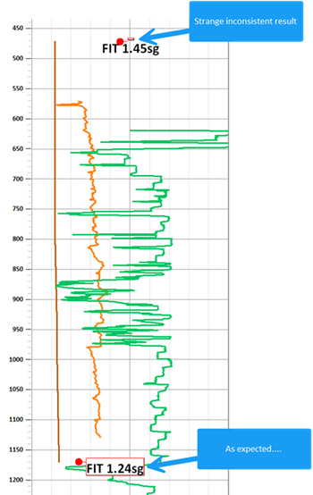

In the same scenario, how can I resize the marks (TPositions) when the font size has changed? Series.Marks.ResetPositions just before Chart.Draw and Chart.DrawToMetaCanvas seems to have no effect and I have also tried something like below, but this gives my inconsistent results.
procedure TSeriesAdaptor.SeriesGetMarkText(Sender: TChartSeries; ValueIndex: Integer; var MarkText: string);
var
  XPos, YPos: Integer;
  inherited;
  if assigned(Sender.Marks.Positions[ValueIndex]) then
    Sender.Marks.Positions[ValueIndex].Custom := true;
    XPos := Sender.CalcXPos(ValueIndex);
    YPos := Sender.CalcYPos(ValueIndex);
    Sender.Marks.Positions[ValueIndex].LeftTop.X := XPos + TCustomSeries(Sender).Pointer.Size * 2;
    Sender.Marks.Positions[ValueIndex].LeftTop.Y := YPos - TCustomSeries(Sender).Pointer.Size;
    // ATTEMPT TO RESIZE/FIT TEXT HERE......
    Sender.Marks.Positions[ValueIndex].Width := Sender.ParentChart.Canvas.TextWidth(MarkText);
    Sender.Marks.Positions[ValueIndex].Height := Sender.ParentChart.Canvas.TextHeight(MarkText);
    Sender.Marks.Positions[ValueIndex].ArrowFrom.X := XPos;
    Sender.Marks.Positions[ValueIndex].ArrowFrom.Y := YPos;
    Sender.Marks.Positions[ValueIndex].ArrowTo.X := Sender.Marks.Positions[ValueIndex].LeftTop.X;
    Sender.Marks.Positions[ValueIndex].ArrowTo.Y := YPos;
Any ideas or suggestions?

Never mind. As I ultimately draws the chart to a metafile, it was simply a matter of first scaling the chart's canvas font to the same size as the (scaled) marks font size. I now changed to the below and all works OK (perhaps a useful post for future reference):
var
  LFontSize, XPos, YPos: Integer;
  inherited;
  LFontSize := Sender.ParentChart.Canvas.Font.Size; // Store current font size
  try
     Sender.ParentChart.Canvas.Font.Size := Sender.Marks.Font.Size;  // Set font to correct size
       // This now yields the desired result :-)
  finally
    Sender.ParentChart.Canvas.Font.Size := LFontSize; // Reset font size
