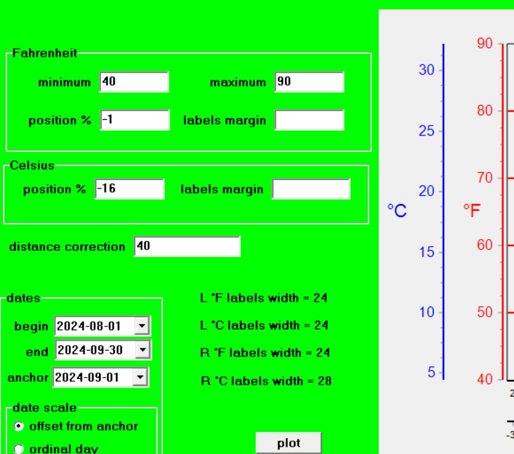

Distance seems to work differently on custom axes from the way it works on native axes. My demo code is in the usual place; the pertinent part of the code (starting at line 118 of ScaleTestMain) is

and the pertinent part of the resulting form is
Screenshot 2024-10-07 123342.jpg (124.75 KiB) Viewed 73216 times
Here the °F title is obviously closer to the red labels than the °C title is to the blue labels, even though the widths of the two label columns are the same. What am I missing?

I've found you've set the LeftAxis.LabelsSize to 12 at design time, which affects the calculations of the margins to be applied.
Setting it to 0 as per default seems to fix the issue for me here.
It was tricky to find it.

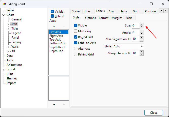

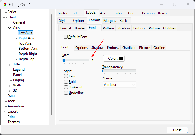

I thought that the <Axis>.Labels.Font.Size slider in the Chart Editor
chart editor.jpg (54.52 KiB) Viewed 71607 times

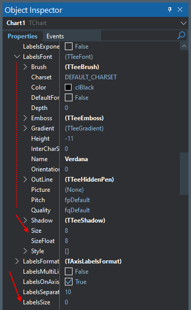

was connected to the <Axis>.LabelSize entry in the Object Inspector
object inspector.jpg (123.04 KiB) Viewed 71607 times
Now I'm curious: What is the Object Inspector entry for?
Re: adaptive use of Distance parameter
Post by Yeray » Fri Oct 11, 2024 7:49 am
These are two different properties: TChartAxis.LabelsFont.Size and TChartAxis.LabelsSize.
Both can be found in the object inspector:
And also in the editor:
