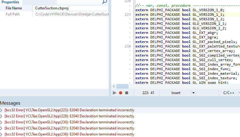

It is TChart Pro 2023, and RAD Studio (C++) 12.2. However, I have had this issue in previous versions as well. I usually just switch to GDI+, but I need to use lighting for this particular project. And, if I use OpenGL in Tee, then I cannot use it in the project itself. I get all types of errors (I have posted about this in the past) if I include "gl/gl.h."

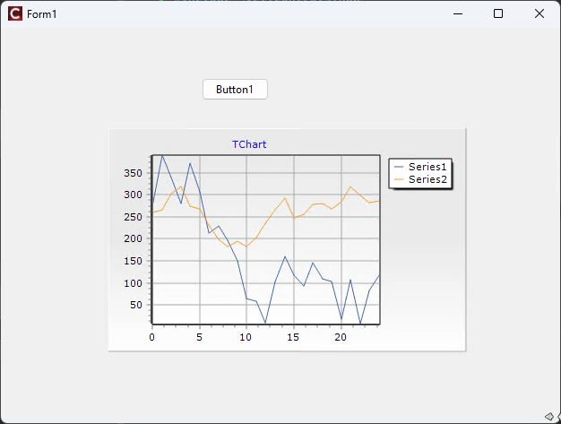

With TeeChart Pro v2024.41 and RAD 12.2, I've just created a new C++Builder project, added a TChart with a couple of TLineSeries and this TButton:
void __fastcall TForm1::Button1Click(TObject *Sender)
  Chart1->Canvas = new TGLCanvas();
And this to the .hpp:
#include <VCLTee.TeeGLCanvas.hpp>
And it seems to work fine for me here:
I haven't tried TeeChart Pro v2023 in RAD 12.2. I assume you had to do some changes to make it compilable.

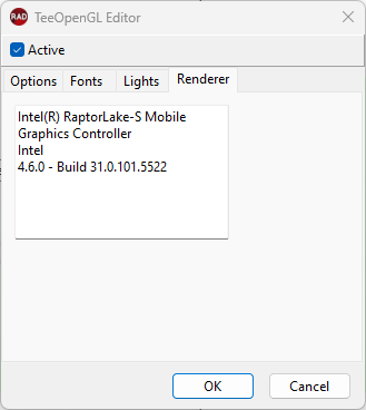

Unfortunately, my projects have many external references, so I would not be able to send you one. However, you are more than welcome to remote in if you would like. I am in the US Eastern time zone and here from 7:30 - 4:00 most weekdays. I did notice one interesting thing. I made a small DLL project and added a TChart with OpenGL and got the following information on the Renderer tab:
Screenshot 2024-09-25 115141.png (10.07 KiB) Viewed 100063 times

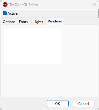

My project is blank:
Screenshot 2024-09-25 115053.png (7.39 KiB) Viewed 100063 times

I figured it out. It does not like being on a PageControl's Tabsheet component set to draw Double Buffered.

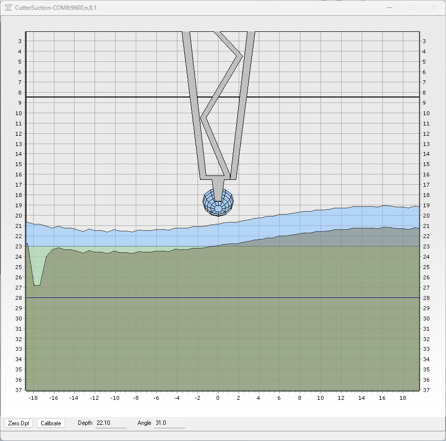

Well, I finally got it showing in Design mode. However, in runtime, it went from:
Screenshot 2024-09-25 125245.png (28.25 KiB) Viewed 100058 times
In GDI+

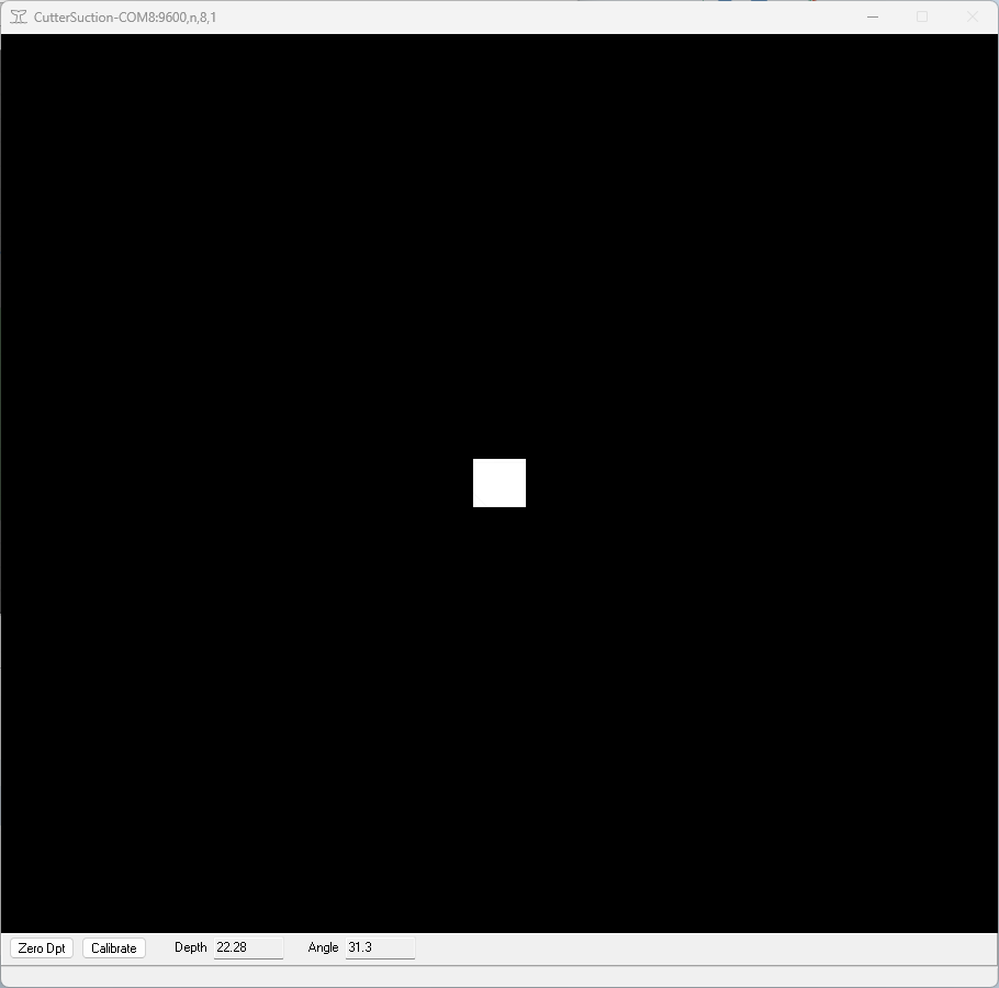

To a flickering black and white window in OpenGL. Is this because there is OpenGL being used in the main executable (remember, this is in a DLL).
