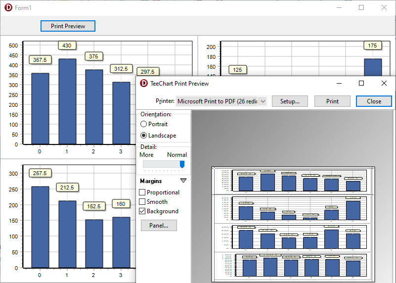

to print several charts on one page I have a form containing a TeePreviewPanel.
In my MainForm I have the following code to show the print preview:
procedure TMainForm.ShowPrintPreview(Sender: TObject);
  Chart1.PrintProportional:=False;
  Chart2.PrintProportional:=False;
  Chart3.PrintProportional:=False;
  Chart4.PrintProportional:=False;
  Chart1.PrintMargins:=Rect(2,2,2,76);
  Chart2.PrintMargins:=Rect(2,25,2,51);
  Chart3.PrintMargins:=Rect(2,50,2,26);
  Chart4.PrintMargins:=Rect(2,75,2,2);
  with frmPrintPreview.TeePreviewPanel1 do begin
    Panels.Clear;
    Panels.Add(Chart1);
    Panels.Add(Chart2);
    Panels.Add(Chart3);
    Panels.Add(Chart4);
   frmPrintPreview.ShowModal;
When the preview form is shown only one chart is visible. Only when i move the window or change its size the charts will be displayed correctly. I have tried to call Repaint and Refresh with no success. How can I solve the problem?

Post by Yeray » Thu Aug 03, 2023 11:09 am
The following simple example seems to work fine for me here:

Post by Metek » Wed Aug 09, 2023 4:11 pm
Hello Yeray,
i was close to desperation to locate the problem in my application, but now I can reproduce it.
In my application each of the 4 charts is assigned to separate page of a PageControl.
If I start the application and immediately call up the print preview before all pages have been displayed once, the print preview does not work. This only happens the first time I call it up.

Post by Marc » Mon Aug 14, 2023 11:43 am
Hello Metek,
I'm checking what repaint method can force the render but haven't found one yet other than CopyToClipboard, which works but, as the name implies, leaves a chart on the clipboard.
ie.
Charts.CopyToClipboardBitmap;

Post by Metek » Thu Aug 17, 2023 6:02 am
Hello Marc,
thanks for the workaround, it works well.
The clipboard can then simply be deleted with Clipboard.Clear

Post by Yeray » Wed Aug 23, 2023 2:12 pm
As an alternative to that workaround, forcing the charts to be drawn works fine for me:
procedure TForm1.BPrintPreviewClick(Sender: TObject);
var preview: TChartPreview;
    i: Integer;
  Charts[0].PrintMargins:=Rect(2,2,2,76);
  Charts[1].PrintMargins:=Rect(2,25,2,51);
  Charts[2].PrintMargins:=Rect(2,50,2,26);
  Charts[3].PrintMargins:=Rect(2,75,2,2);
  preview:=TChartPreview.Create(Self);
  with preview.TeePreviewPanel1 do begin
    Panels.Clear;
    for i:=0 to High(Charts) do begin
      Charts[i].Draw;
      Charts[i].PrintProportional:=False;
      Panels.Add(Charts[i]);
  preview.ShowModal;
  preview.Free;
