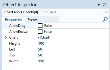

in tools.subchart I can find in the gui "allowdrag" checkbox , but I cant find this for a main chart in a Tform?
Is there a similar property in object inspector or how to do? ( I have unchecked Anchor etd)

Indeed, AllowDrag and AllowResize are properties in TSubChart class, not in TChart class.
The TChart can be positioned as a regular TControl. If you leave the Align property set to alNone as per default, then you can position it using Left and Top properties, and size it with Width and Height properties.
