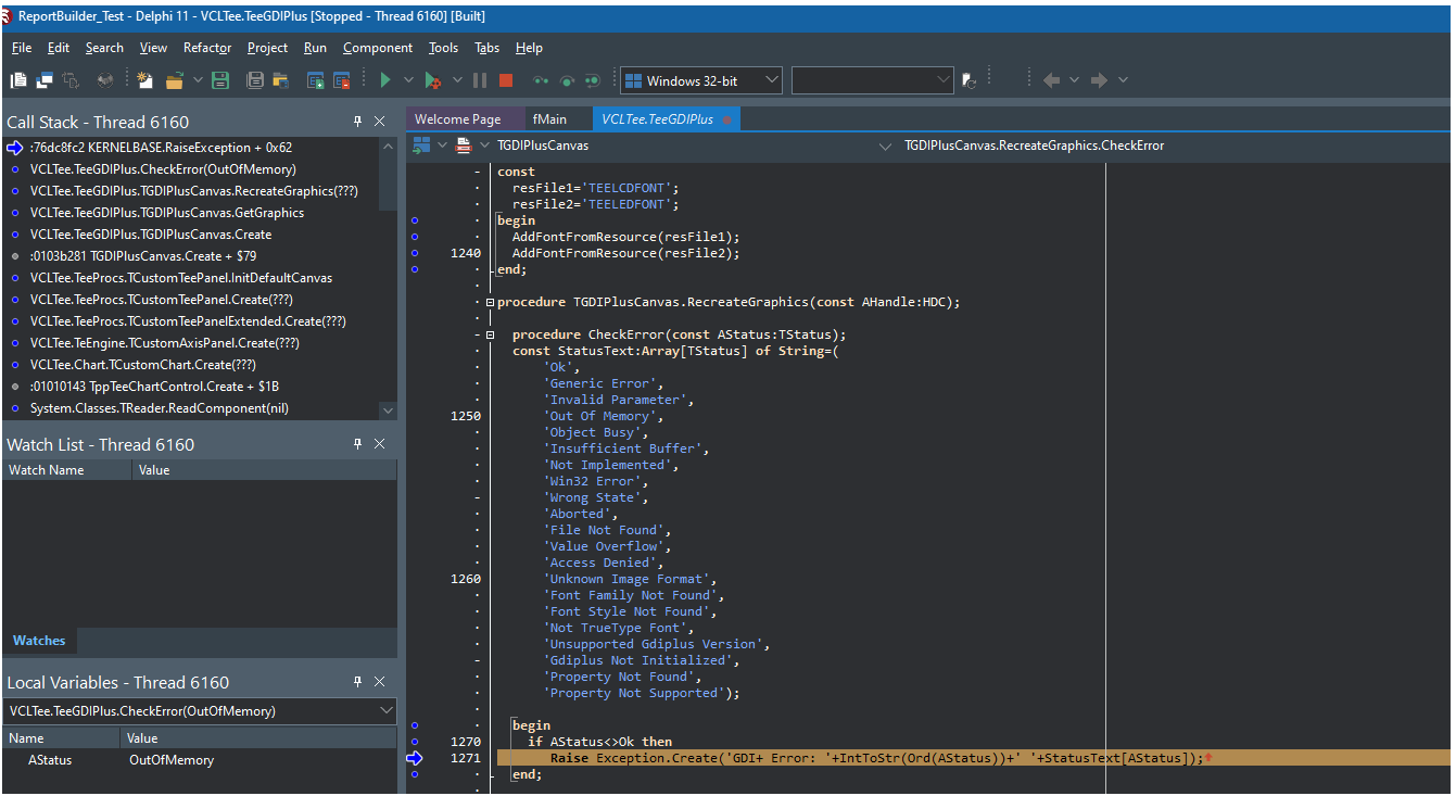

We experience Out Of Memory Exceptions when we print TChart (export to PDF) in our concurrent server environment.
I've managed to create an example application.
What I see is, when using ReportBuilder + Standard TeeChart delivered with Delphi, all seems to be OK.
When I install the TeeChart-pro version (rebuild TeeReCompile and RBTeePackageBuilder) and run the same application (rebuilded) I can reproduce 'Out Of Memory' quite frequent.

Callstack: in attachment (callstack.png)

Thank you for the problem description and sample application. We are able to run your project and reproduce the error you report. The issues have some complexity so it will likely take us some time to work through possible causes. We'll get back to this thread.

As a follow-up whilst we're looking at this. The problem doesn't seem to occur when tested with GDI (not GDI+).
If you'd like to test it, to see whether the output is at a level that is acceptable to you, the quickest way, if you're compiling with TeeChart sourcecode, is to set the default canvas here:
unit VCLTee.TeeProcs;
initialization
  //TeeDefaultCanvas:={$IFDEF FMX}''{$ELSE}'TGDIPlusCanvas'{$ENDIF}; //commenting this line
  TeeDefaultCanvas:='';  //<- adding this line
There's a registry setting that controls that I think; I'll need to check, but the sourcecode mod will let you test it.

Yes, we'll run some checks. GDI+ is known to suffer problems when many handles are requested via multiple threads but we are curious that it should have behaved differently with the TeeChart Standard version shipped with Delphi so we'll look for differences.

I'm afraid there's still a problem with using GDIPlus in multiple threads.
Since metafile doesn't require GDIPlus, the workaround is to set GDI canvas.
