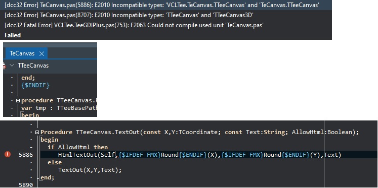

I,ve installaed and builded/installed the source code version.
When I try to compile a simple app with only a Tchart on the main form I got the error shown in the attached image (the error is in TeCanvas.pas)
Could you help me?
