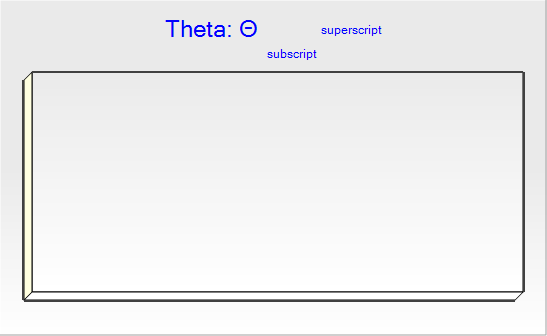

Thanks for the further suggestions. That is (almost) what I want...
Both the subscript and the superscript appear to be too low relative to the regular text. Is there any way to control that?

What I'm really looking for is this...

Post by Yeray » Mon Mar 16, 2020 11:01 am
This is an issue already in the public tracker (#1907) I'm currently revising.

Post by Geocentrix » Mon Mar 16, 2020 12:43 pm
Thanks for the additional info.
Looking at the proposed fix in the database, I would like to make the following commets:
  • The upwards and downwards offsets are MUCH better
  • However, there should be lest space between the end of the regular text and the beginning of the sub/superscript
Will the fix make it in the next release?

Re: How to display Greek symbols on axis labels?
Post by Yeray » Mon Mar 16, 2020 6:11 pm
I'm not sure because I've just seen this is breaking other html tags such as <big> and <small>
So we should revise it.

Post by Yeray » Fri Mar 20, 2020 9:50 am
Andrew,
In general we need to calculate the text size with a margin.
This is related to this old issue.
