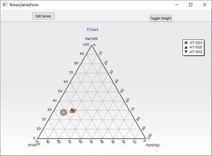

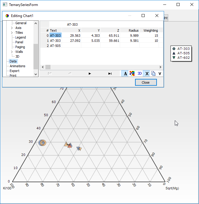

I am having continuing problems assigning the Weighting parameter in a ternary graph, as follows:
1. If I do not assign this parameter, the graph does not draw.
2. If I assign it to the Weight field from my input memory table (derived from a csv file), the Weighting value is set to zero, and the Y field is filled with the Weight values.
3. If I assign the parameter to the same field as the Radius parameter, the Weighting is still zero, but at least the Y field is filled to the correct values.
I have attached a simple example project that shows these effects. I would be grateful if you could indicate what I am doing wrong here.
Many thanks
Errol
TernaryGraph_Weight.zip
(8.82 KiB) Downloaded 1909 times
Re: Ternary Graph Assigning the Weighting parameter
Post by Yeray » Mon Mar 25, 2019 3:32 pm
As mentioned here this project seems to be using components we don't have here (TkbmMemTable, TkbmCSVStreamFormat).
If you still find problems with it, could you please arrange example projects using the minimum code to reproduce them and without using 3rd party libraries?

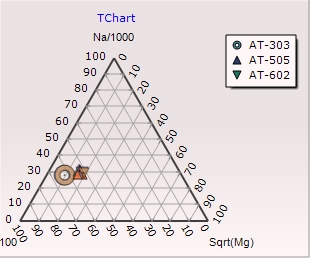

Find attached the project modified to use the TSeriesTextSource instead of the kbmMemTables. It seems to work without problems:
(3.01 KiB) Downloaded 2269 times

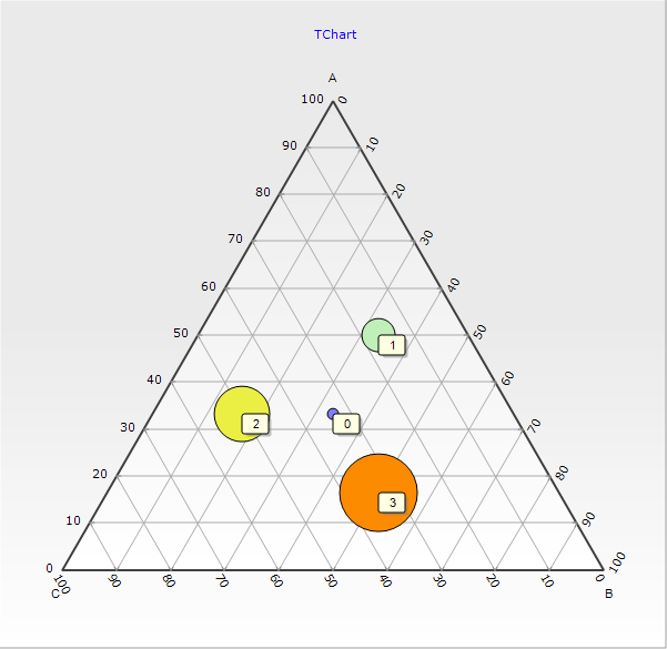

I'm sorry to hear that. The Ternary series is a quite particular series that draws elements (like axes) in it's own way so it doesn't receive improvements and fixes made in other parts of the chart as other series do.
If you can help us to identify and report with detail any issue you may find with it, it would help us to improve this specific series.

The weight list is used to fill the colors of the points in range and palette styles. The point with the lowest weight is drawn with the end color in the palette, the point with the highest weight value is drawn with the start color in the palette, and the rest of points are drawn with a color calculated by extrapolation.

The way the Ternary Series was devised was to use 5 components:
X,Y,Z values and Radius and Weight.
X,Y and Z position the point as a measure of proportionality of each of the three values. Radius decides the visible radius of the point and Weight uses a colour scale.
This code then plots four points, one equidistant from each axis (centered) and the other offset proportionally as per their values:
procedure TForm13.Button1Click(Sender: TObject);
  Series1.AddBubbleXYZWeight(10,10,10,5,1,clTeeColor);
  Series1.AddBubbleXYZWeight(30,20,10,15,2,clTeeColor);
  Series1.AddBubbleXYZWeight(20,10,30,25,3,clTeeColor);
  Series1.AddBubbleXYZWeight(10,30,20,35,4,clTeeColor);
  Series1.UsePalette := True;
  Series1.TernaryStyle := tsBubble;
  Series1.Marks.Style := smsPointIndex;
output:
TernarySeries won't share the chart with other series types so they need to be Active:=False;

procedure TTernarySeriesForm.FormCreate(Sender: TObject);
var
  i: integer;
  inherited;
  FormatSettings.DecimalSeparator:='.';
  for i:=0 to 2 do
    with TTernarySeries(Chart1.AddSeries(TTernarySeries)) do
      case i of
        0: begin
             Title:='AT-303';
             Pointer.Style:=psDonut;
        1: begin
             Title:='AT-505';
             Pointer.Style:=psTriangle;
        2: begin
             Title:='AT-602';
             Pointer.Style:=psDownTriangle;
      if i>0 then
        VertexTitle.Hide;
        Chart1.Axes.Hide;
        BeforeDrawValues:=BeforeDrawSecond;
      end
        BeforeDrawValues:=BeforeDrawFirst;
      OnAfterAdd:=SeriesAfterAdd;
      DataSource := SeriesTextSource1;
      with SeriesTextSource1 do
        HeaderLines:=1;
        FileName := 'Na-Mg-K.csv';
        FieldSeparator:=',';
        Fields.Clear;
        AddField('X',3);
        AddField('Y',4);
        AddField('Z',5);
        AddField('Radius',6);
        AddField('Weighting',7);
        AddField('Text',8);
        Load;
      UseColorRange:=true;
      VertexTitles[0][0] := 'Na/1000' ;
      VertexTitles[1][0] := 'Sqrt(Mg)' ;
      VertexTitles[2][0] := 'K/100' ;
      Pointer.Transparency:=50;
      ShowInLegend:=False;
      UseColorRange:=False;
      OnGetPointerStyle:=SeriesGetPointerStyle;
  for i:=0 to 2 do
    with TPointSeries(Chart1.AddSeries(TPointSeries)) do
      Title:=Chart1[i].Title;
      Pointer.Style:=TTernarySeries(Chart1[i]).Pointer.Style;
  Chart1.Legend.Title.TextAlignment := taLeftJustify;
  Chart1.Legend.Width :=30;
  Chart1.Legend.Title.Visible:=true;
  Chart1.Walls.Back.Hide;

Hello Errol,
Re.
However, I have another question. In the test program (TernaryGraph_Weight.zip) provided earlier in this thread, the code is shown below. In this code, I do not understand how Chart1[ i ] is created. When I try to emulate this code, I cannot create an "apparent" array of charts, which I presume is why I am not getting any output.
Firstly, your project has highlighted a bug between SeriesTextSrc and the Ternary Series. I noticed it when looking at the Y values reported in the data section of the Editor. Y is coming up as the Weighting value. That's because (the bug) SeriesTextSrc uses what's called the MandatoryValueList for its second value. For most Series Types Y is mandatory (ie a chart could be created with x as a sequential index but Y needs to have some significance). For the case of Ternary X,Y,Z are all treated as equals and it's Weight that shows the true value difference and that was chosen to be Mandatory. That's being erroneously picked up by SeriesTextSource.
I put in a temporary fix for your project which generates the Chart image attached. Notice that Ternary points have moved respectively. We'll revise how best to apply this fix for inclusion with the next release update.
That doesn't answer your question though.
Your test project loads via SeriesTextSource to several Series. Have you considered loading this as one Series?
eg. ... you can still use the SeriesTextSource instead of the i loop.
