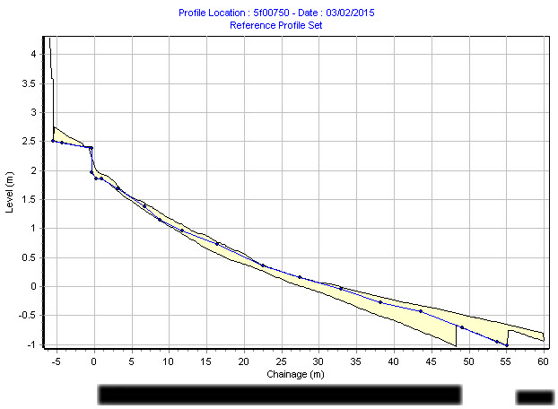

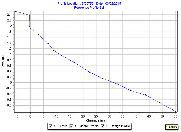

I have a chart plotting a line series but when I add a HighLow series the Legend and Annotation tool are blanked out.
I've just updated to version 2018.25 from 2017.21, so this bug has been introduced since then.
Sean.
Normal Chart showing Line Series
Chart with line and HighLow Series showing blanked Legend & Annotation
