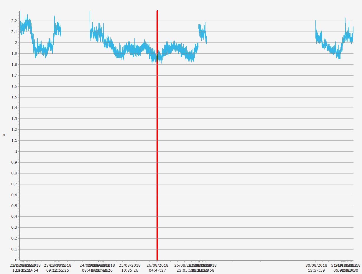

I am using TeeChart Pro with Delphi Tokyo. I want to draw a fastLine serie with empty values.

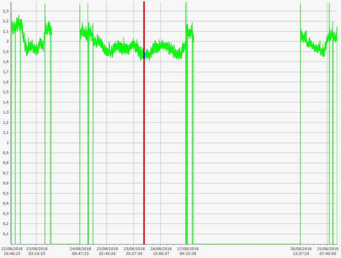

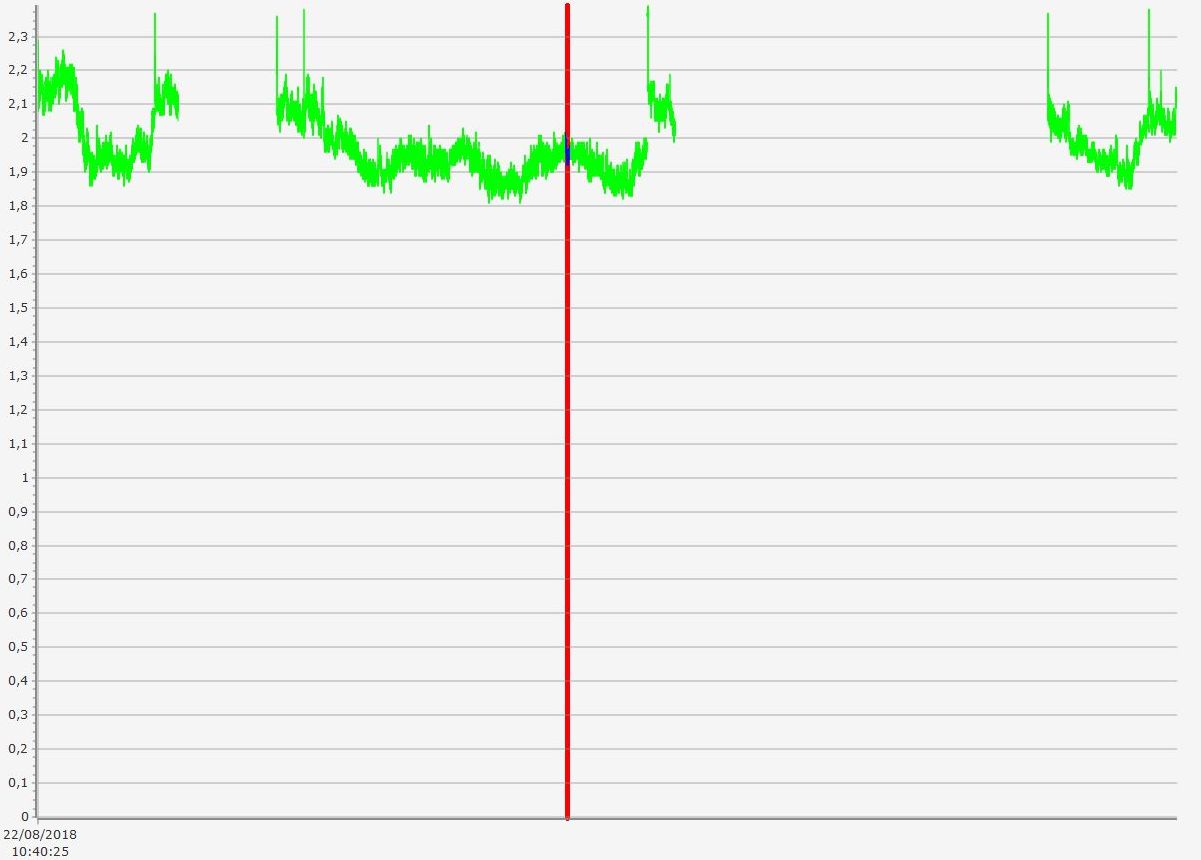

I tried to add empty values with the AddNullXY method but I have vertical lines to 0:

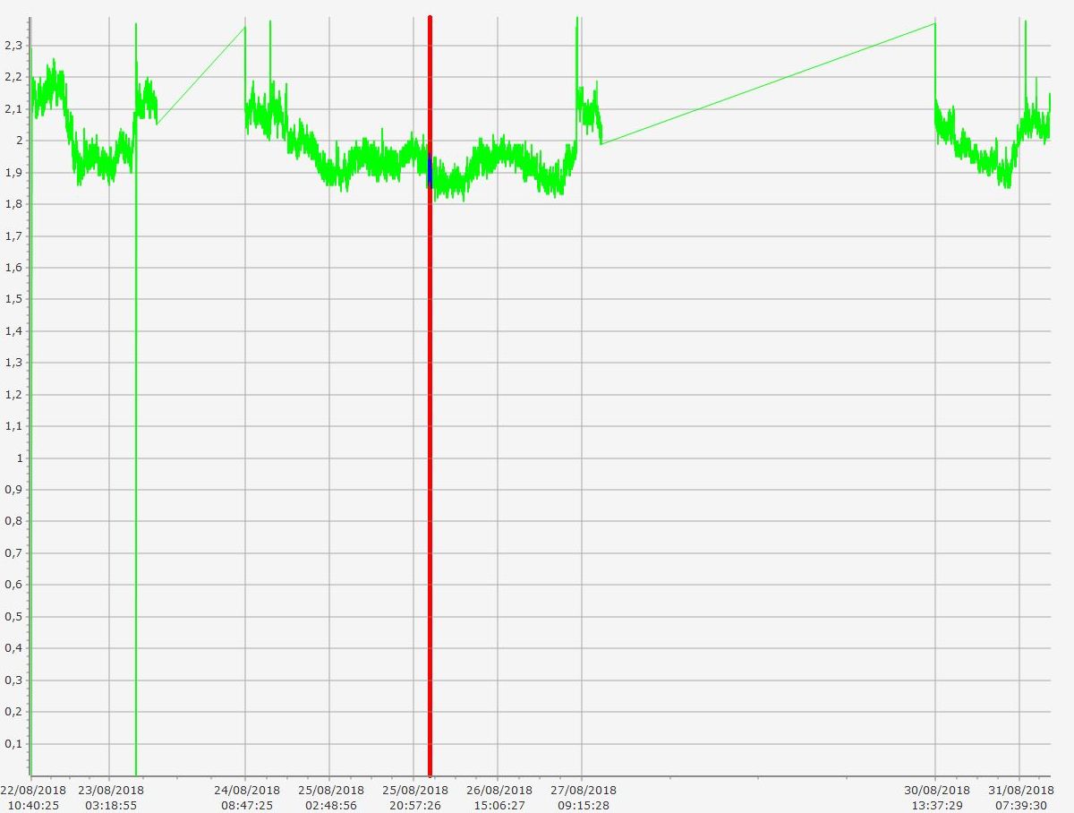

I tried to add empty values with the AddXY(0,0) method but I have diagonal lines connecting last and first visible values:
I thought I found a way to have what I want using multiple series: I create an new serie when previous values is empty:
The rendering is OK but I have a TCurorTool object (red vertical line) that shows serie values. When using muItiple series, I can't use TCurorTool OnChange event :x
My issue is: how can I get last display with one serie or how can I get serie values with TCurorTool ?

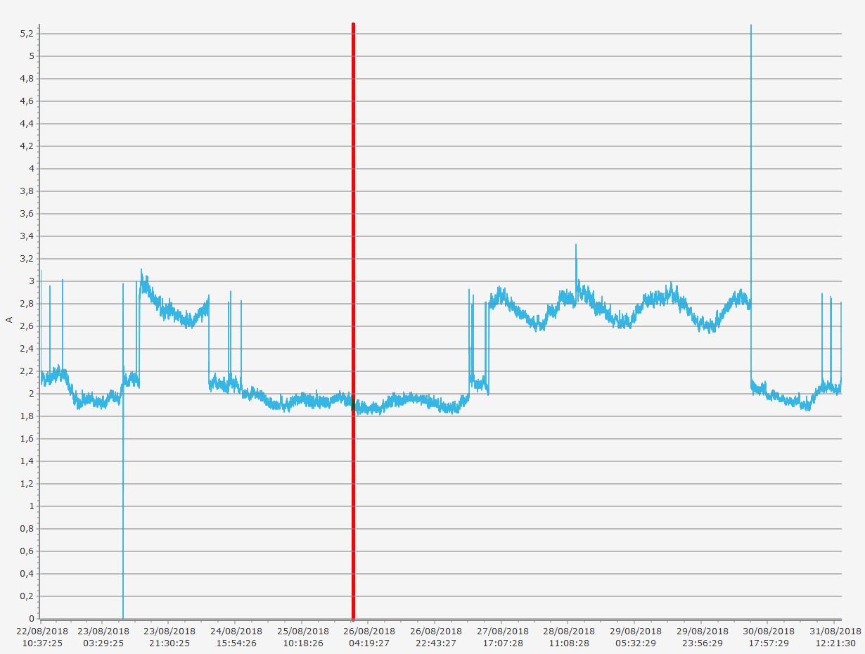

I tried your solution, it barely works. I still have an issue when displaying datas (dates) in abscissis.
In the picture above, I have one serie and I display dates in abscissis --> everything is OK
In the picture above, I use your solution, I have many series and I display dates in abscissis --> labels overlap
I dont' find a way to have a correct display. Do you have an idea ?
