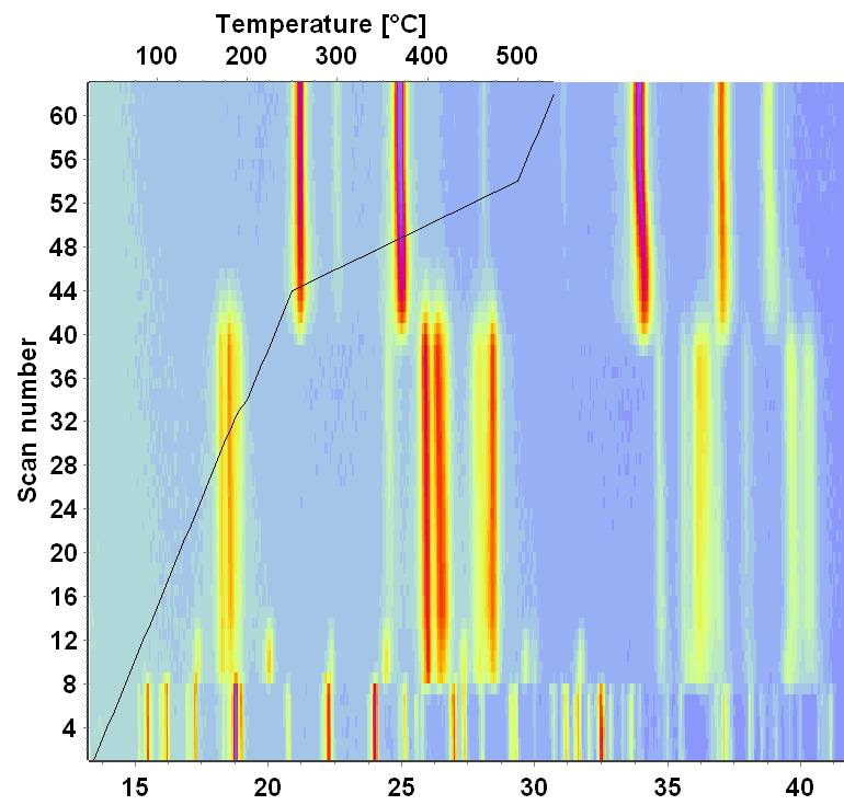

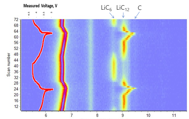

How to best create this kind of chart
Post by X-ray » Fri Jun 15, 2018 8:32 pm
I have a chart with a ColorGrid series and I would like to display a vertical line series (red line) on top of this ColorGrid.
The Left axis is actually the same axis for both series (Scan Number) the top axis should display the X values of the line series (Measured Voltage V)
Whats the best way to achieve that ?
Thanks and best regards
Re: How to best create this kind of chart
Post by Yeray » Mon Jun 18, 2018 7:23 am
The easiest way is probably yo assign the Top axis to the THorizLineSeries and set that axis to limit the length of that axis. Here I'm setting it to end at the 20% of the chart width:
uses TeeSurfa, Series;
var colorGrid1: TColorGridSeries;
    horizLine1: THorizLineSeries;
  Chart1.View3D:=False;
  Chart1.Legend.Hide;
  colorGrid1:=Chart1.AddSeries(TColorGridSeries) as TColorGridSeries;
  horizLine1:=Chart1.AddSeries(THorizLineSeries) as THorizLineSeries;
  colorGrid1.FillSampleValues;
  horizLine1.FillSampleValues;
  horizLine1.HorizAxis:=aTopAxis;
  Chart1.Axes.Top.EndPosition:=20;

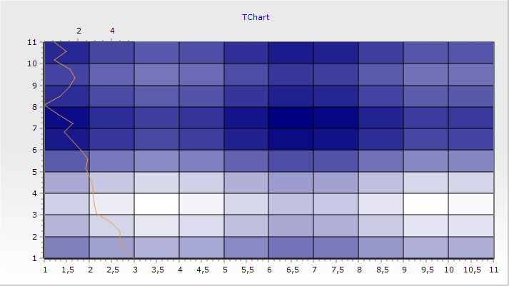

Post by X-ray » Mon Jun 18, 2018 6:04 pm
Hello Yeray,
I got it right for the TColorGridSeries series now :

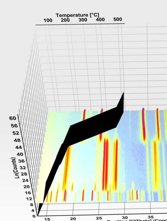

How to get it right for a similar TSurfaceSeries:
I somehow can't see how to get the axis right....
Thanks in advance!
Post by Yeray » Tue Jun 19, 2018 6:49 am
X-ray wrote:I got it right for the TColorGridSeries series now :
Great!
X-ray wrote:How to get it right for a similar TSurfaceSeries:
I'm not sure to understand what would you exactly like it to get.

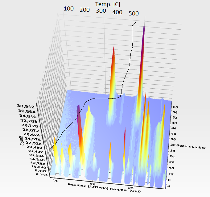

Post by X-ray » Tue Jun 19, 2018 7:48 am
Hello Yeray,
I want to achieve that:
The line can be drawn at any height of the {Counts} axis.
[Scan Number] should be the common axis again.

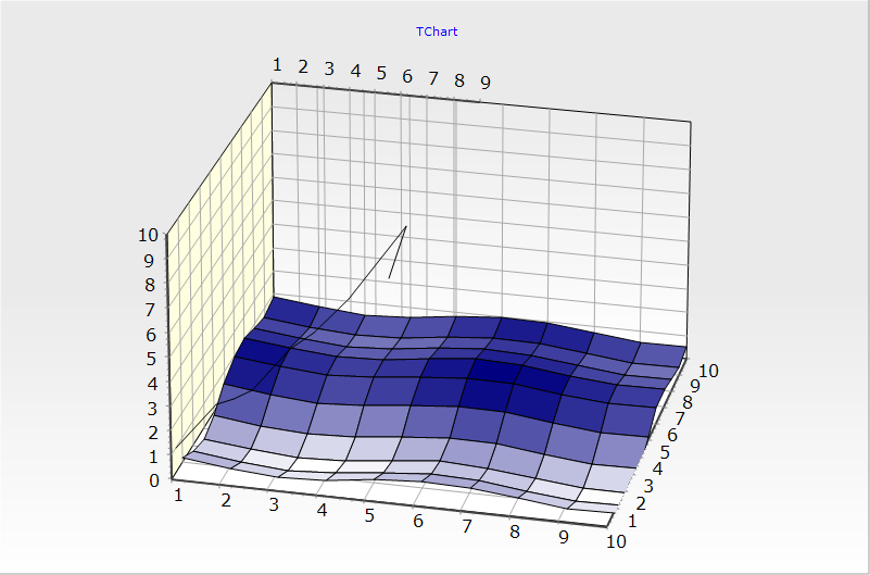

Post by Yeray » Tue Jun 19, 2018 11:07 am
For this kind of chart I would use a TPoint3DSeries with hidden Pointer. Ie:
var surface1: TSurfaceSeries;
    points1: TPoint3DSeries;
var i: Integer;
  Chart1.Legend.Hide;
  Chart1.Aspect.Orthogonal:=False;
  Chart1.Chart3DPercent:=100;
  Chart1.Aspect.Zoom:=60;
  Chart1.Axes.Left.SetMinMax(0,10);
  Chart1.Axes.Left.LabelsFont.Size:=20;
  Chart1.Axes.Bottom.LabelsFont.Size:=20;
  Chart1.Axes.Top.LabelsFont.Size:=20;
  Chart1.Axes.Depth.LabelsFont.Size:=20;
  Chart1.Axes.Depth.Visible:=True;
  Chart1.Axes.Bottom.Increment:=1;
  Chart1.Axes.Depth.Increment:=1;
  Chart1.Axes.Left.Texts.MarginToAxis:=100;
  Chart1.Axes.Top.Texts.MarginToAxis:=100;
  surface1:=Chart1.AddSeries(TSurfaceSeries) as TSurfaceSeries;
  surface1.FillSampleValues();
  points1:=Chart1.AddSeries(TPoint3DSeries) as TPoint3DSeries;
  points1.Pointer.Hide;
  points1.HorizAxis:=aTopAxis;
  Chart1.Axes.Top.EndPosition:=50;
  for i:=1 to 9 do
    points1.AddXYZ(i, i, random*i);
