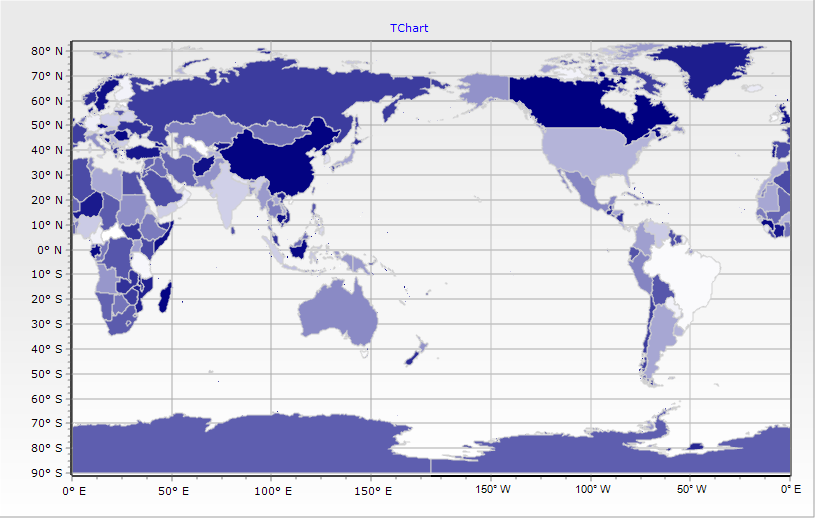

How can I use the TWorldSeries for a Pacific centered map, so that it uses 0 to 360 degrees instead of -180 to +180 degrees?

You could use two TWorldSeries. The first one to draw from 0 to 180 and the second one to draw from -180 to 0. Ie:
uses TeeWorldSeries;
var Series1: TWorldSeries;
var tmpSeries: TWorldSeries;
  Chart1.View3D:=False;
  Chart1.Legend.Hide;
  Series1:=Chart1.AddSeries(TWorldSeries) as TWorldSeries;
  Series1.FillSampleValues();
  with Chart1.Axes.Bottom do
    EndPosition:=50;
    SetMinMax(0, 180);
  tmpSeries:=CloneChartSeries(Series1) as TWorldSeries;
  with Chart1.CustomAxes.Add do
    Horizontal:=True;
    StartPosition:=50;
    SetMinMax(-180, 0);
  tmpSeries.CustomHorizAxis:=Chart1.CustomAxes[0];
  tmpSeries.ParentChart:=nil;
  Chart1.AddSeries(tmpSeries);
