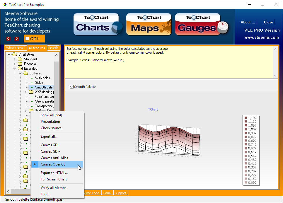

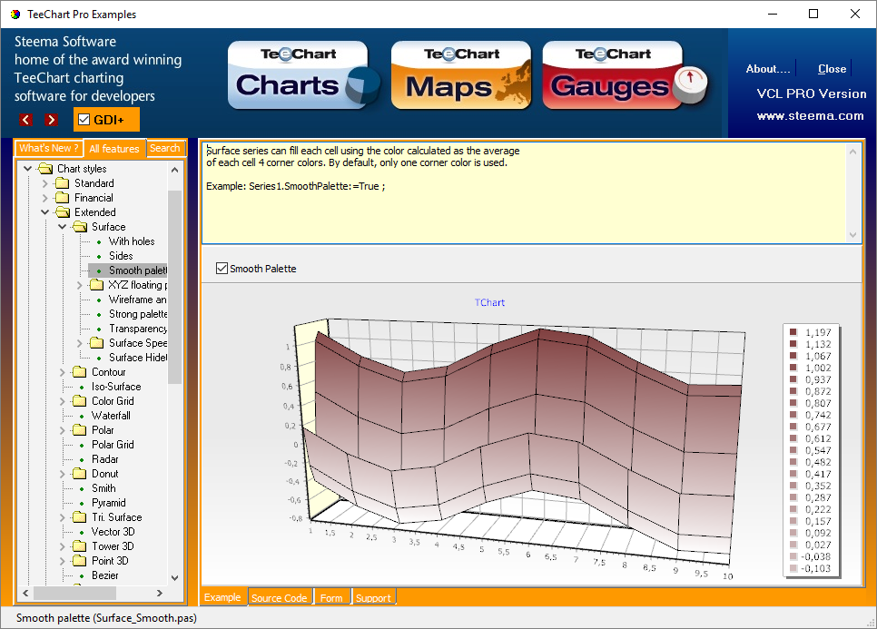

Here how the "Surface_Smooth" example looks by default using GDIPlus:
Changing the Canas to OpenGL from the status bar contextual menu also changes the zoom. Is this what you mean?

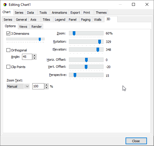

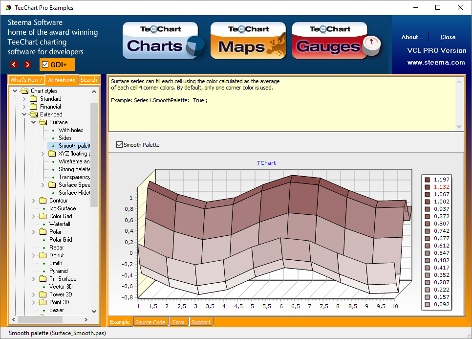

However, if you change the Canvas from the "Chart\3D\Render" tab, and you unselect "Orthogonal" checkbox from the "Chart\3D\Options" tab, it looks much better:

Thank you for the hint, I was not aware of right-click status bar menu in this Demo. Because of this I listed only examples with explicit "OpenGL" option. Using this menu I can say that most of 3D examples have this problem: the size and in most cases viewpoint are changing very significantly when I switch between OpenGL and GDI renderings.
The same happens in my project if I switch rendering in the code. In my view it is a big issue preventing me from using OpenGL rendering without additional tweaks.

Using the "SeriesType_Surface" example, by default you can see these Aspect settings:
Changing to OpenGL using the contextual menu, it changes the Zoom:
If, instead of using the contextual menu, you change to OpenGL through the Editor, nothing else is modified and it looks good:
