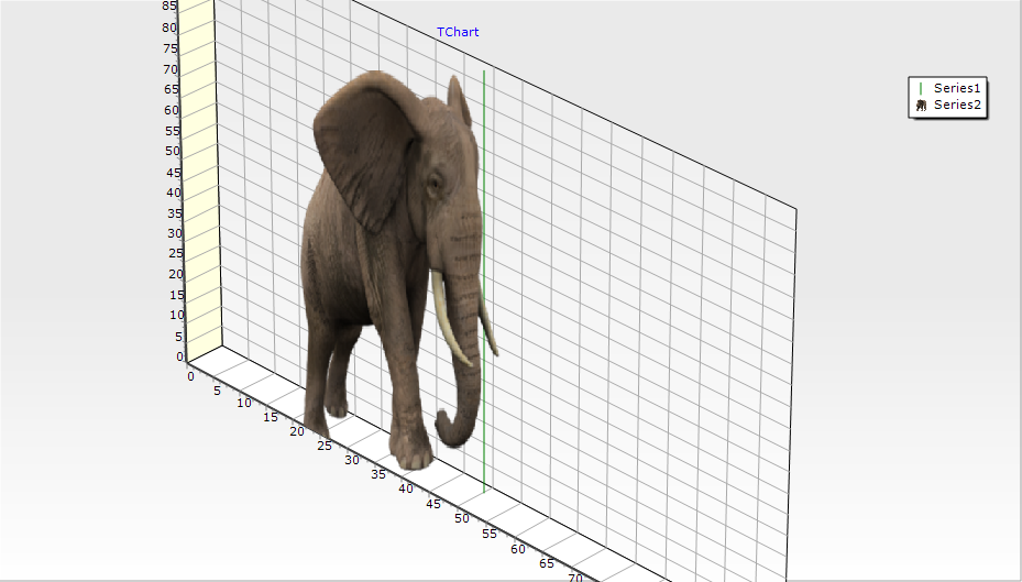

MatsOle wrote:2) Is it possible to define own simple symbols like (U, E, I, T, etc) that will work when the chart is rotated.
I'm afraid that's not possible. However, you could save your symbols in images and use them in a TImagePointSeries. Ie:
uses TeeShape, ImaPoint, TeePNG;
  Chart1.Aspect.Orthogonal:=False;
  Chart1.Aspect.Rotation:=315;
  Chart1.Aspect.Elevation:=330;
  with Chart1.AddSeries(TChartShape) as TChartShape do
    Style:=chasVertLine;
    Pen.Color:=clGreen;
  with Chart1.AddSeries(TImagePointSeries) as TImagePointSeries do
    AddXY(40, 50);
    Pointer.Size:=300;
    ImagePoint.LoadFromFile('E:\tmp\transparent_elephant.png');
  Chart1.Axes.Bottom.SetMinMax(0,100);
  Chart1.Axes.Left.SetMinMax(0,100);
I'm using an elephant but you can use any symbol.
