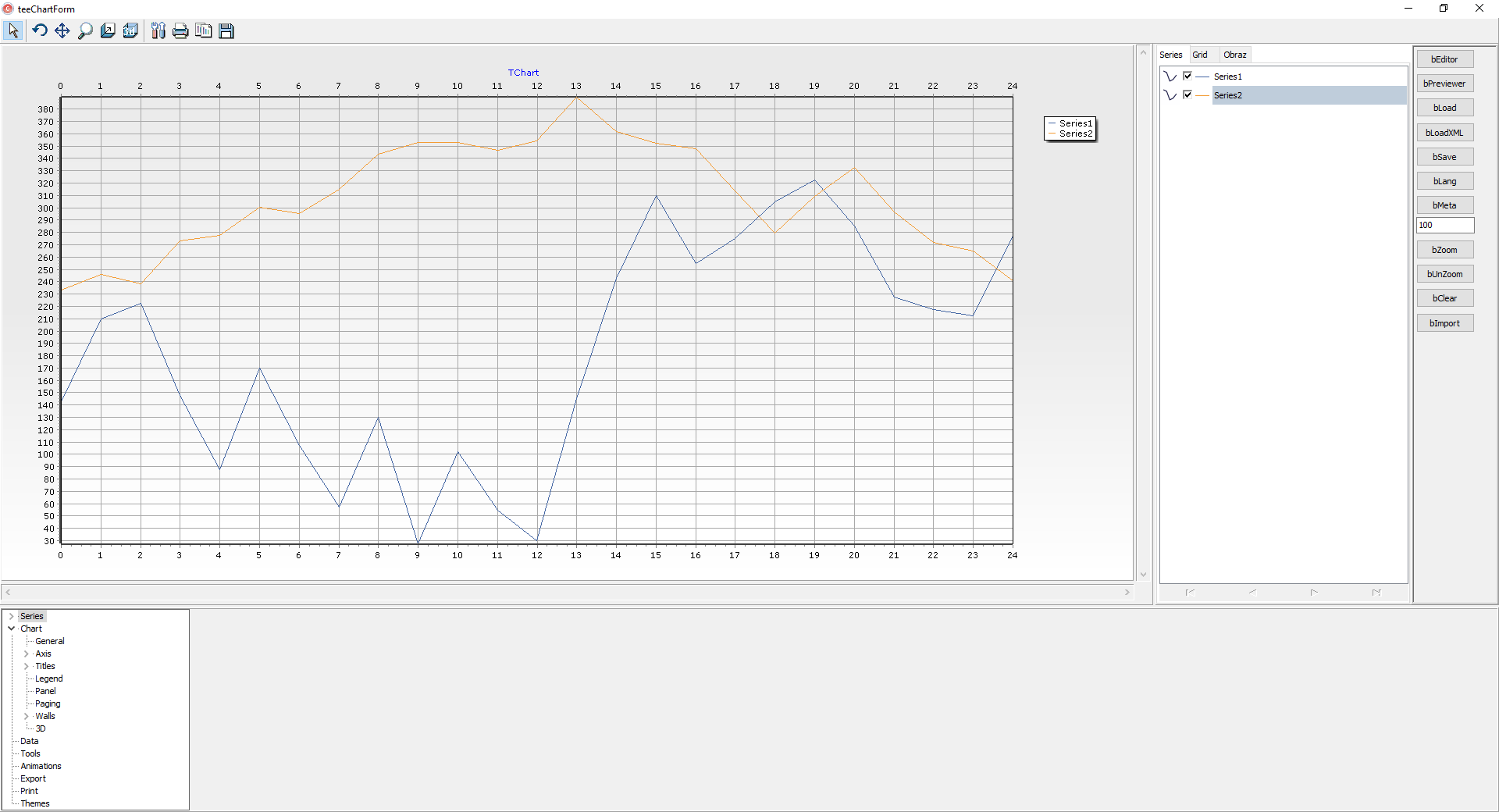

TChartScrollBar doesn't scroll correctly when one series is attached to bottom axis and second series is attached to top axis.
Initial chart

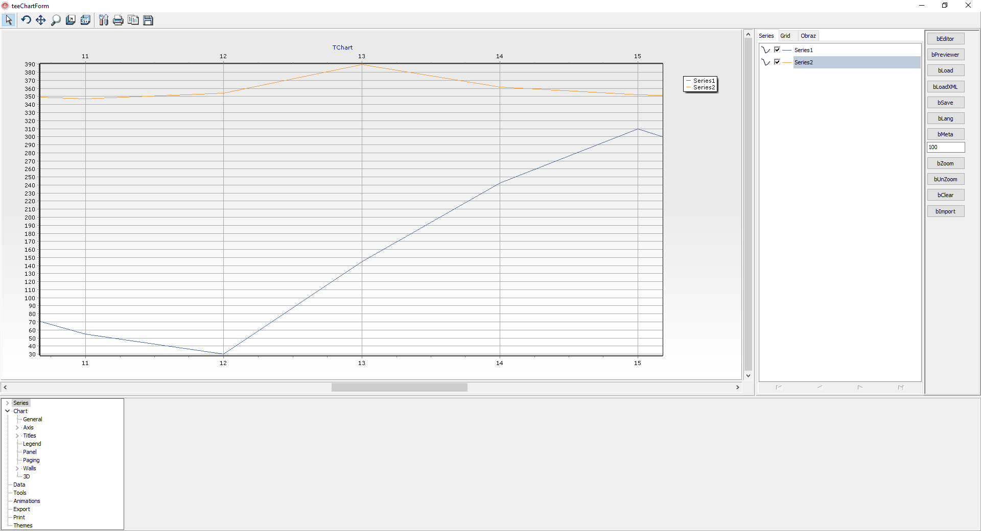

After zoom

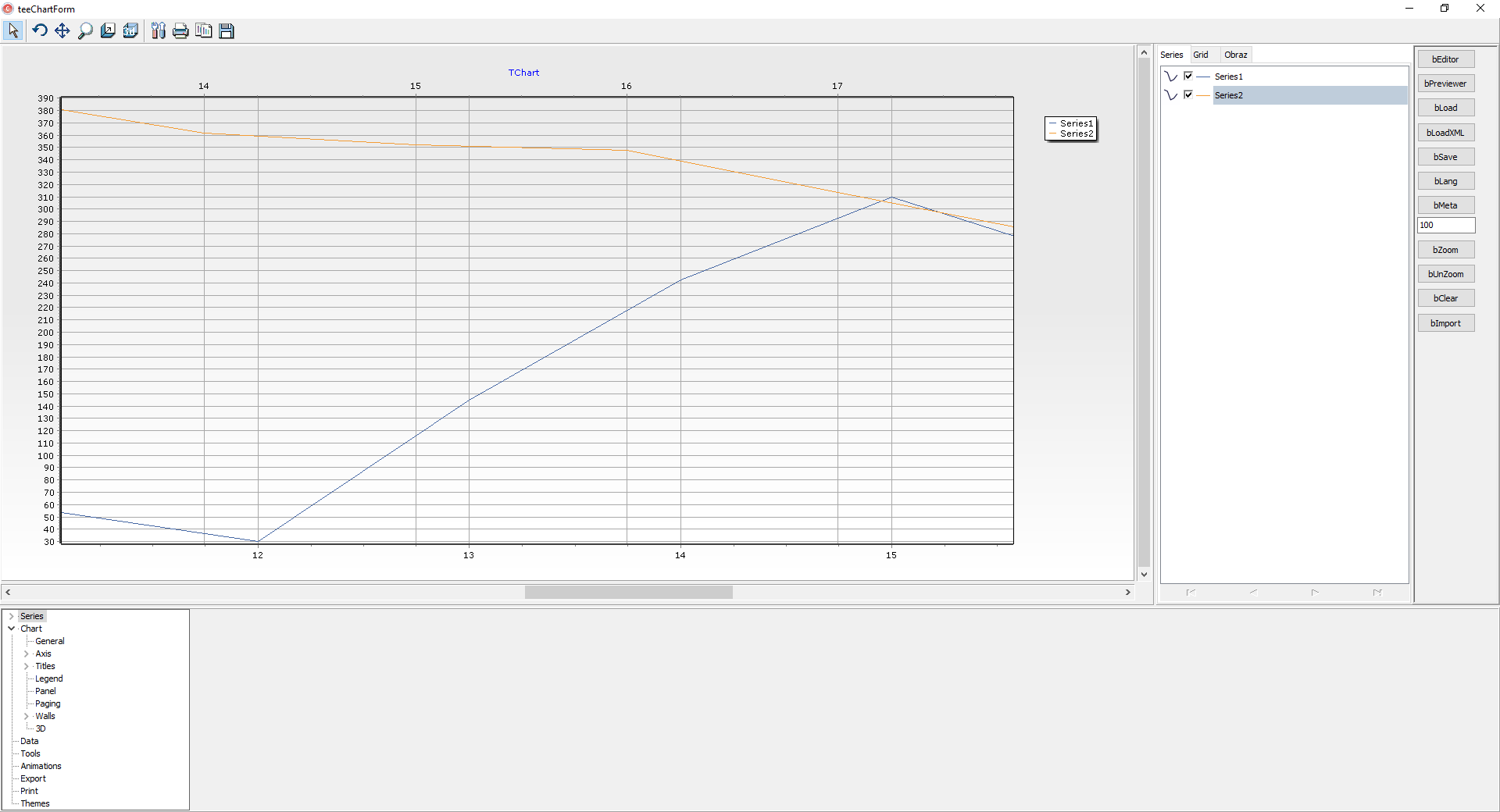

After move scroll
Is it possible to force TChartScrollBar to obey axis settings like pTChartAxis->ExactDateTime = true; pTChartAxis->Increment = DateTimeStep[dtFifteenMinutes];

Hi Grzegorz,
We use to recommend to use the standard TScrollBar instead of TChartScrollBar because it presents some problems in complex situations like this.
I'm sorry for the inconvenience.
