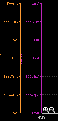

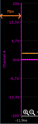

I attached two images. Width.png shows alignment for single axis and constant 70px of Chart.MarginLeft. Second picture aligned_axes.png shows two axes aligned left and they are aligned at same 70px spacing (relative to each other) which is not OK as you can see orange axis is overlapping title of purple one. So I would like o calculate the size to set up chart.LeftMargin properly so that axes will be positioned properly according to font size etc..
