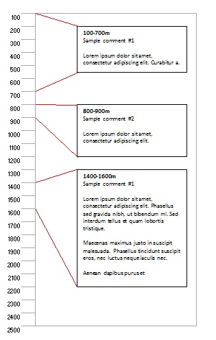

I am trying to achieve a chart output similar to format shown below (hand-drawn to give you an idea).
Sample chart.jpg (44.06 KiB) Viewed 5659 times
The general idea is that the left (inverted) axis relates to a depth. I am trying to plot comment boxes that relate to specific depths / depth ranges. I have tried TAnnotationTool, TRectangleTool and a ShapeSeries. When the chart is zoomed/scrolled the text boxes must be scaled / displayed accordingly.
So far the ShapeSeries appears to give the best result, but unfortunately HTML text output is not supported. Do you have any ideas / recommendations how to achieve such a chart? I am a relative newbie, so some guides is likely to save me a lot of time!

Post by Yeray » Wed Apr 20, 2016 12:39 pm
Hi Mark,
You could try doing something like this:
